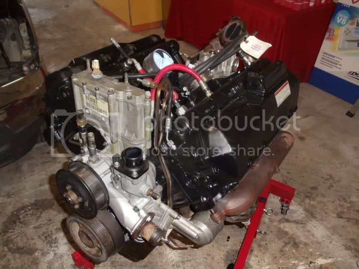

My block is painted black but I really wish I would have done silver incase I ever had a leak it would make it a lot easier to spot!
Here is the best shot I can find of my engine as it was going back together
