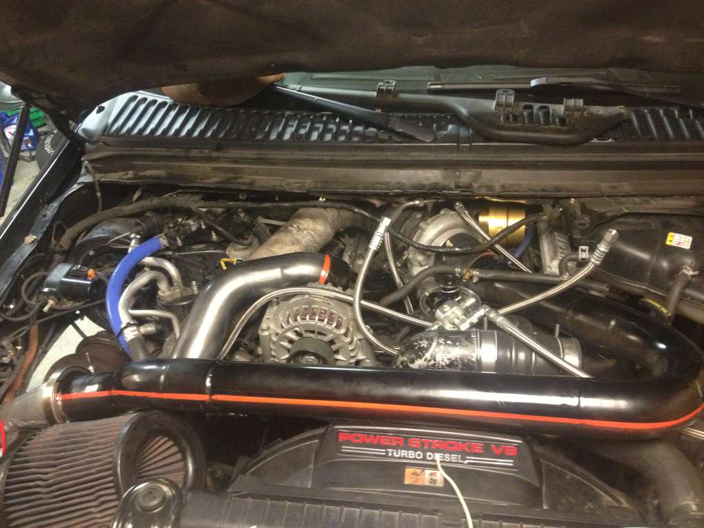

Build thread.
After buying kevins compound kit from the classifieds, im going to try it out on small fuel first and see how it does. Set up is
155/30s
Rr fuel
Bd thruster 62/65/70 with diverter
S478
Banks ic
I've seen a few posts over the years of people asking about it, but not really any that have done it(I'm sure there has). Also going to play around with ficm tuning to help spool them.

Well it's up and running. Took a little longer then I expected, but didnt help the retard working on it poked a hole in the oil pan when tapping for the drain(me) Ill have a few vids next week on it, but so far empty it's just an animal, pulls hard on every gear, makes 40lbs with my little 155/30s (for reference a stock turbo made 24, the 64 made 28~30) take a bit to spool them hard, but still makes a couple pounds on light take off.
dohcter
Mar 5, 2012
201
What tunes are you running, did it keep your egts cooler?
That setup looks nice.
Currently running Eric's xtreme x tune, php Hercules ficm. Playing with ficm tunes Egts are cooler across the board. It's nice cruisin down the interstate at 550~600 at 65.
