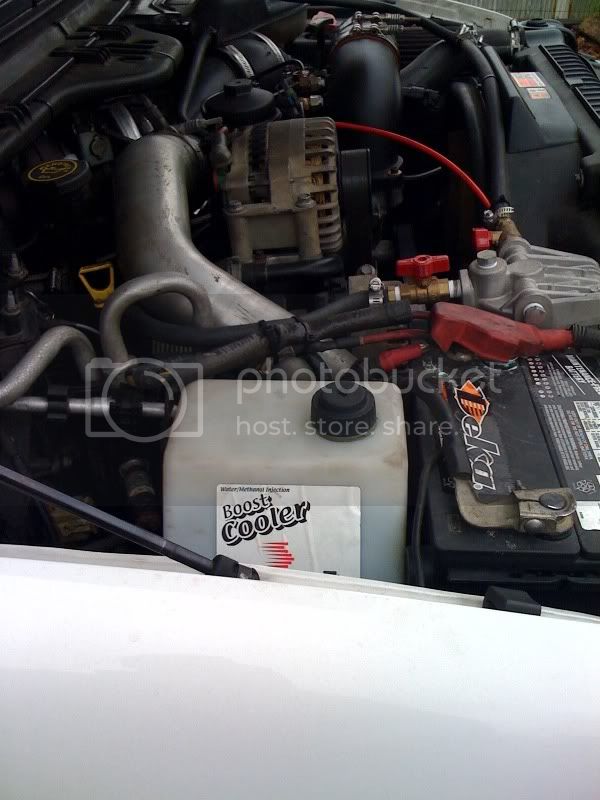

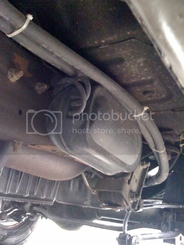

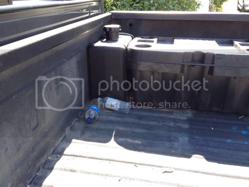

Post some pics of where you mount the tanks. I, along with everyone else would like to see them.

Very basic
