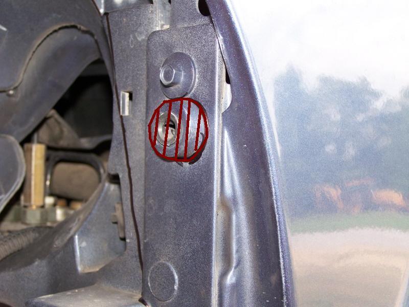

1. Remove Grill
2. Remove old Headlights

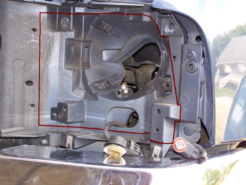

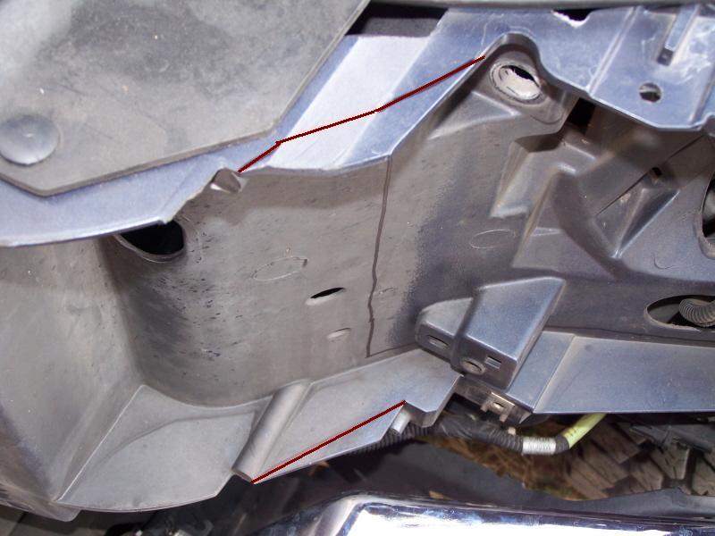

3. Cut existing Header Panel:
You have to cut your header Panel as shown:
