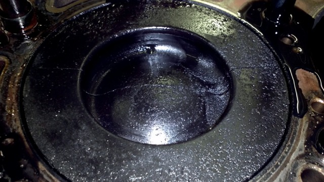

ok no high oil temps or anything of that such. i have 63000 on my truck last 40000 have been with tune and wastegate just curious if that makes a differance. I am hoping to look at the engine with a borascope when I pull the injectors and see what the back pistons look like.
I havent found a boroscope that handy in finding the crack, unless its really big. The crack is almost always at the 3 o'clock or 6 o'clock position on the edge of the bowl from what ive seen atleast. When you look with the camera, your looking through the injector hole in the center and cant really see the edges very well. Plus there is usually soot and some diesel fuel that gets in that hides the crack. So just cause you dont see it through the injector hole doesnt mean its not there.

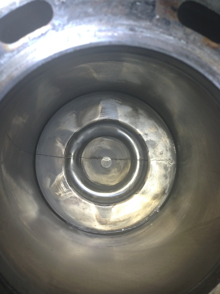

Generally they crack along the plane that is parallel to the pin bore of the piston in any engine. That being because it is the thinnest place. That doesn't rule them out from cracking other places as well. The 6.4 piston on general is a poor design for many reasons one being the hollow cooling cavity cast into the bottom of the bowl area. The skirt and pin bore areas are also weak by design. Also whenever you can minimalize the bowl lip it will remove a thin spot where heat can't dissipate very fast and cracks start to form.
[ImageUploadedByTapatalk1357627037.038615.jpgATTACH]13106[/ATTACH]
these are of a Dmax I'm building right now. Guy had big compounds, dual pumps and nozzles. Cast pistons will not take that abuse very long......oh yea and that brings me to the last weak point of 6.4 pistons, cast aluminum!
