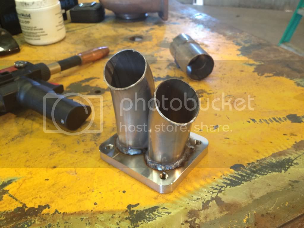

t4

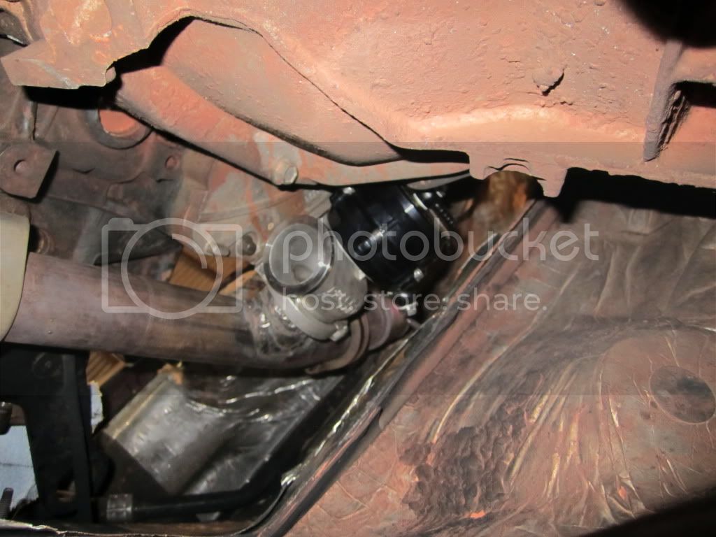

wastegate

Matt will you do an open t3 flange or only divided? Also will you make them without bellows (solid)

I could do what ever you want man. T3 open wouldn't really matter because it would be divided with the pipes anyway if that makes since. Unless you wanted it to collect in to one pipe before the flange.

you honestly can only do a t-3 open.
theres just not enough room to divide to 2" pipes in that flange.
for a true divided turbine setup,one would need at least t-4

Thats why I was asking that T3's are tiny, Matt says is possible though ;)
Only gripe I have about doing a T3 is not being able to benefit from a larger diameter up pipe.

it would become the biggest restriction in the whole system. esp if hes crushing the pipe down.(like a formed pipe to fit in the flange)
i understand anything is possible,but why would you do it

Its not really a restriction if youre merging them into a single/open flange. It could be better but its far better than the stock collector either way.

T3 open yes i agree.
T3 divded would be a problem.
