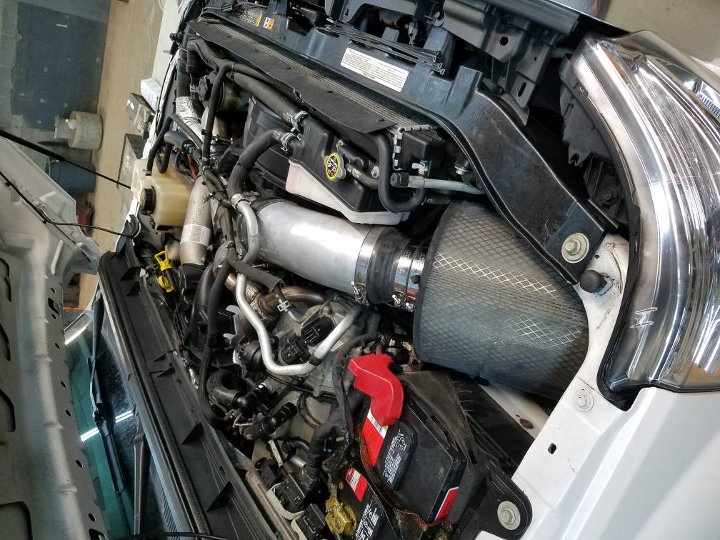

SickSeven780
Mar 19, 2017
26
This is the one I built for mine.

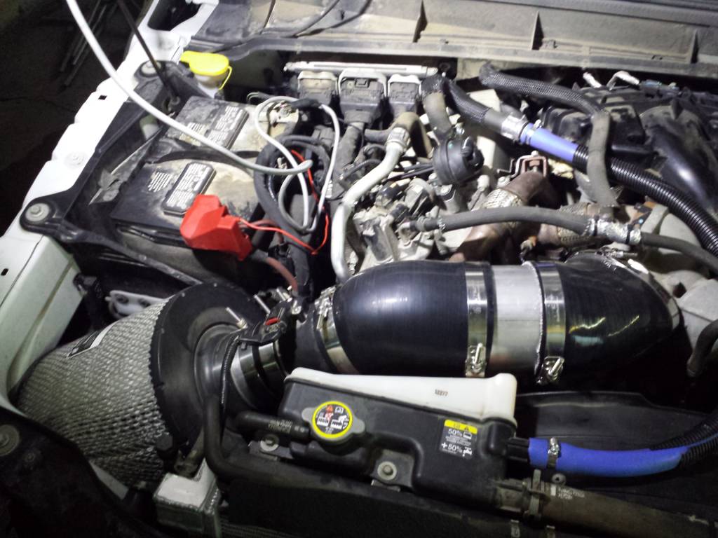

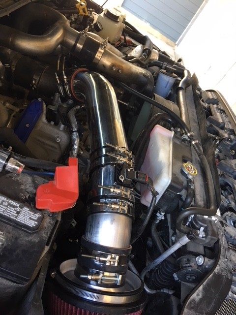

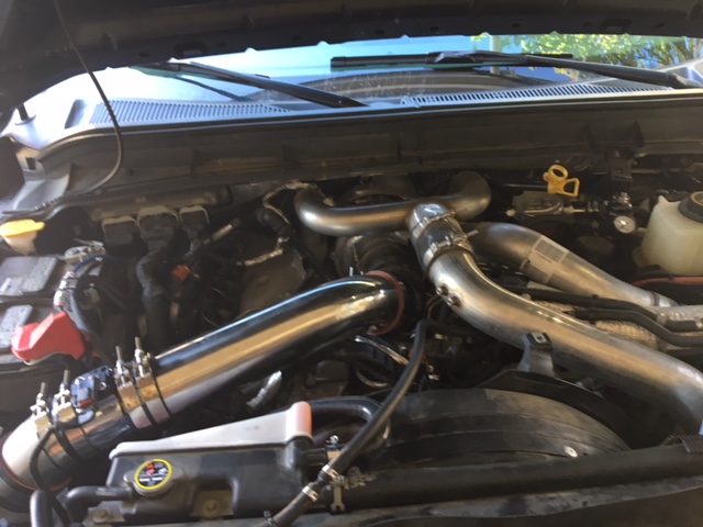

Here is mine. First 2 are my 15 with a no limit 5" tube and the last one are my 12 with a 5 inch and homemade tube.
