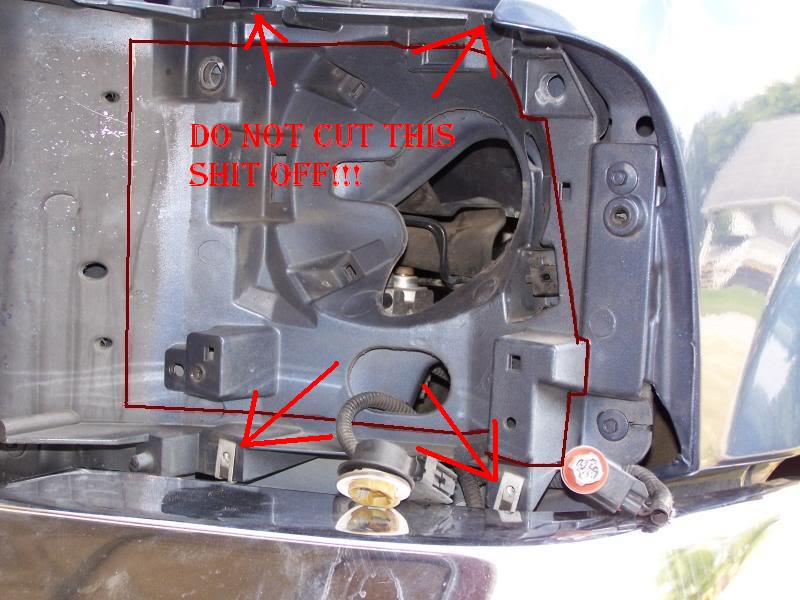

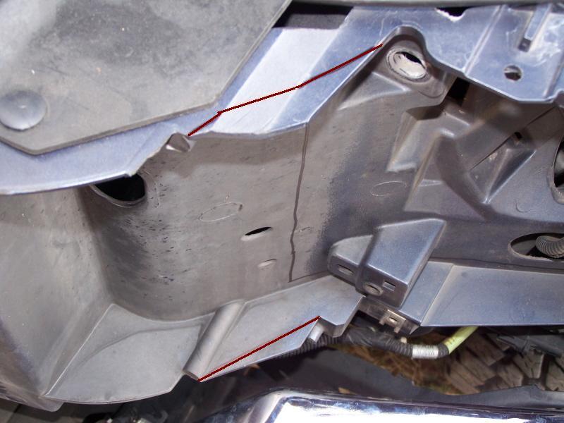

For those that want to cut:

I had to cut up a little.higher than that smitty. I got my lights to fit snugly without putting any screws in. Im impressed that my lights are as solid as they are considering I removed most of the panel behind the headlights.

I removed exactly what was shown in those pics, and they fit perfect, didn't even have to go back and trim anything. I used the screw holes at the bottom, then some plastic GM Body panel push fasteners to hold it at the top, never had a problem.
Those fasteners are in the holes where the locking.tabs are?
