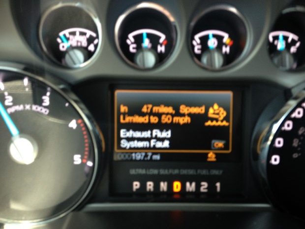

.......Now if there is validity in this, while I know DEF is readily available in consideration to how often you need to add it, my question falls more on a problematic sesor or something that would just cause an issue alog the road somewhere. .....
I guess Karma got the best of me on this one. Good thing I wasn't in the middle of KS or something.
Sorry for the crappy pic...

So the truck will actually limit speed etc if levels get low...ok.
And there should be no worrie that at some point a sensor failure would leave you stranded?
And I guess I answered my own question on if it would leave me stranded. :fustrate:
Nope just limit speed. :D

No clue. BUT...I did run into my mechanic who said it must be a sensor as I should see a different screen when I'm out of DEF. In turn he did convience me that they just dont see these trucks in very often and if they do it's something simple, like a sensor. He had to throw that in there. HaHa

Alright I got the truck back earlier. Hopefully the info I got will help someone in the future.
Under the Labor & Parts section it reads as follows: Customer states exhaust fluid fault light on advise test drive. Verified exhaust fluid fault light on. Diesel diag with IDA. Code P204F. Checked OASIS. Found TSB 12-3-5 Reprogrammed PCm and TCM and perormed SCR Dosing meaurment test per TSB 12-3-5 passed. Test drove for 15-20 min.
In short I guess there was something that needed to be re-programed and I was told they added 1gal of DEF.
That being said, I drove it and it was fine on the way home. BUT...when I arrived home it smelled really hot. My complete guess is that it has gone through its first regen phase and that is what I was smelling.? Dont know as I've never owned a DPF truck.
Either way it seems to run fine now.

My bossman's 2012 kept saying that and limiting him to 50mph. Ended up being a sensor
