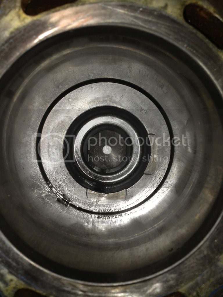

Maybe it was a piston coming up, when the valves were still hangin open, and the piston said to the valves: "You guys go back the way you came!"

I didnt even know it was hitting it until i saw the video. You cant hear crap in the cab. all you hear is the sound of air moving lol.
This is a possibility since both intake and exhaust rods were bent on the same cylinder.
but i dont think they were bent at the same time. After my 11.0 pass it had a hard spot when cranking and miss at idle. Ran a easy 13 pass just to win first round eliminations and next pass I sprayed it and ran a 12.0 and had a really bad miss and miss all the way threw the RPM band not just at idle. I hope to get the head off tonight to see whats up.

we have contact. but notice it is only on the intake side. the other pistons have a slight marking on them not near as noticeable as this one.
Do I win a T-shirt or anything? :shrug:
At least you know where to notch the pistons now...:doh:
Call up the guy's I told Tim (Dapilot) about long time ago.
Smith Brothers Racing. Get some cromoly pushrods in that bish.
