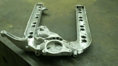

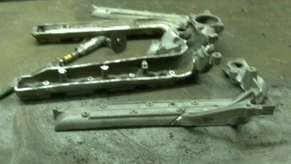

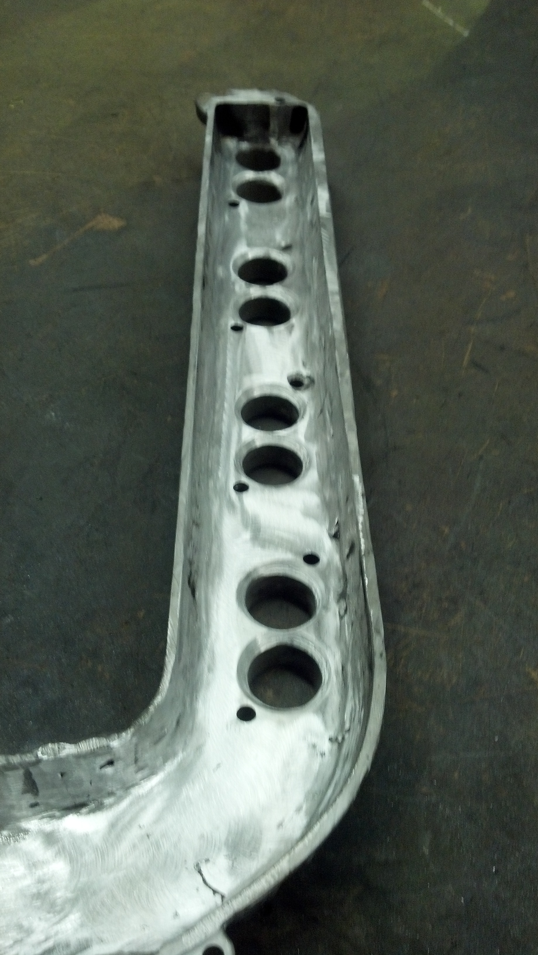

I dicided to port my own manifold, have done all with die grinder, and saw all. I could have used mill but what fun would that be, besides I wanted to show it can be done with hand tools. Now how the he** I'm I going to get it back together, JB weld, bondo, epoxy, No I'm going to weld the whole thing back together. I had some extra time at work so I figured why not play with a manifold. I picked this one up cheap so if it doesn't work who cares, I did notice that while I was cutting the manifold apart that there was alot of build up in it( soot, carbon). If someone was taking the manifold off to do maintenance, it would be well worth having it professionally cleaned, that by itself would help the flow. Here's some pictures of the progress, and far from being done.

I will not be making these for sell, it is just an example of what can be done.I don't even know if it will flow very good, not saying it will or not, just something to play with at work.

No thanks, it's not going to happen. Takes way to much time to do this mod, I would rather just hang with the turbos. I'm thinking about sending it to soot power to have him flow check it just for kicks, or just stick it on the truck and see what it will do. I have a stock intake now, I could pull a dyno with it or track it, and then change the manifold only to see what happens, what you guys think?
