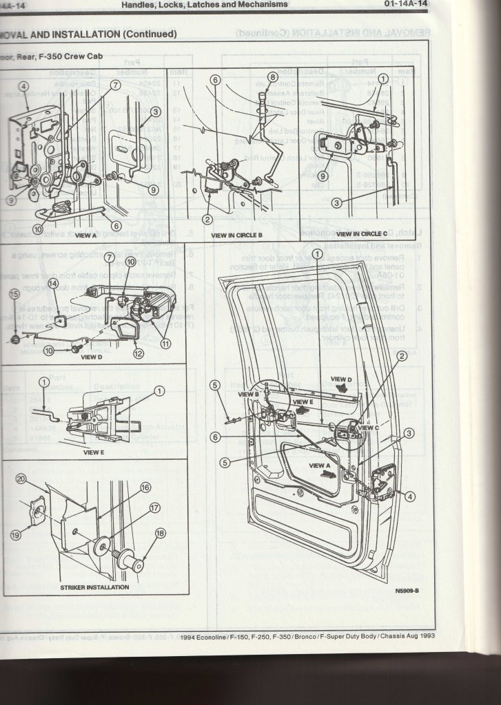

See if this helps. I couldn't post the better version here (too large), so check your PSN thread for a better one. Cheers!

Aug 12, 2011
459
13
Parker, TX
It's from my 1994 factory service manual (Body/Chassis volume). I mainly use my DVD versions (I have 1996-2001), except for the Electrical and Vacuum Troubleshooting Manuals (EVTMs) which I have in paper (94 and 97). Cheers!
