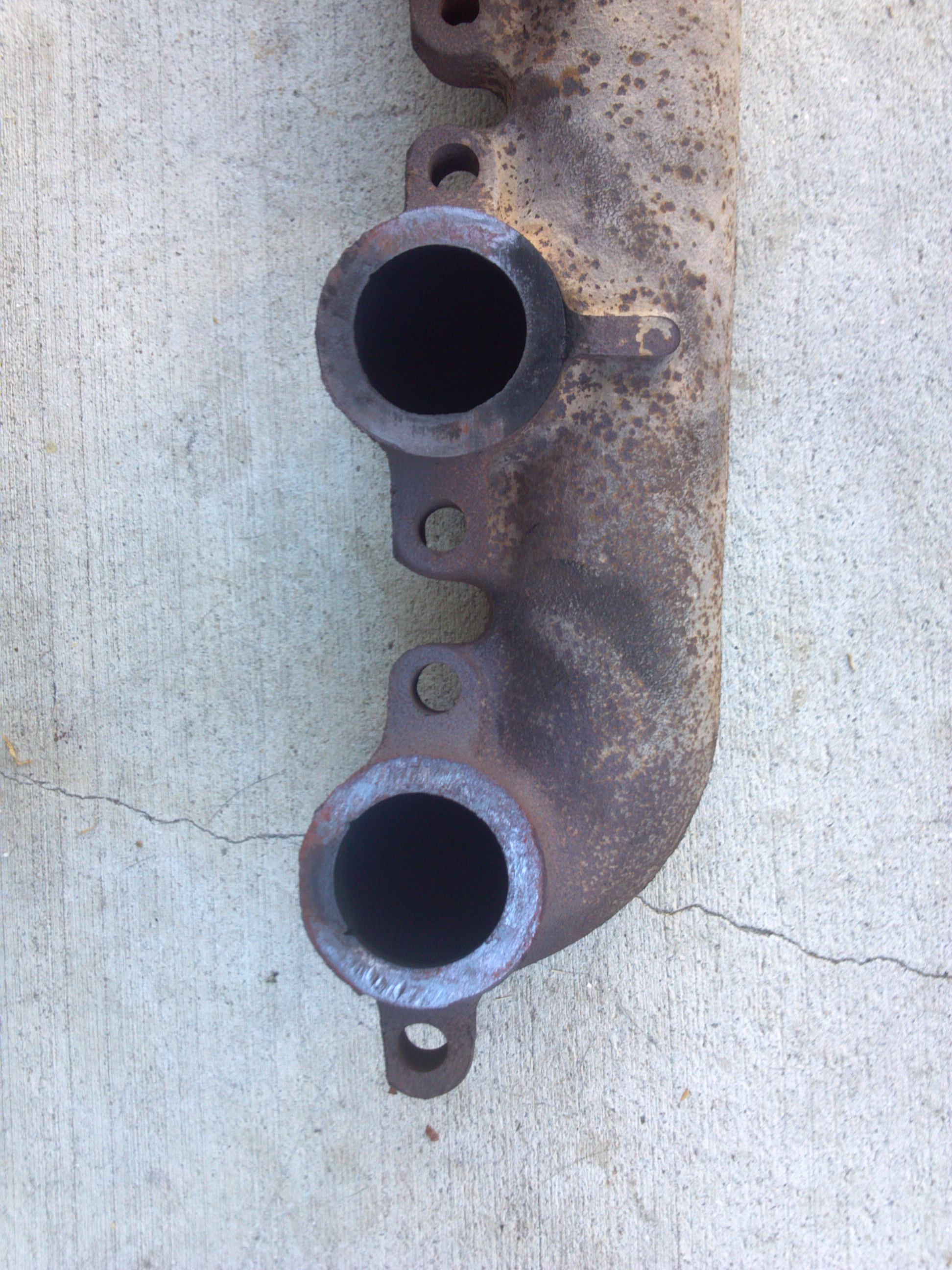

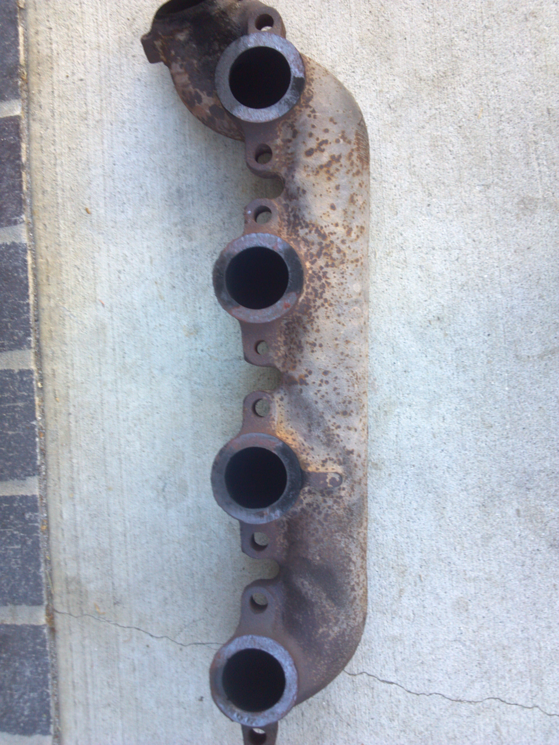

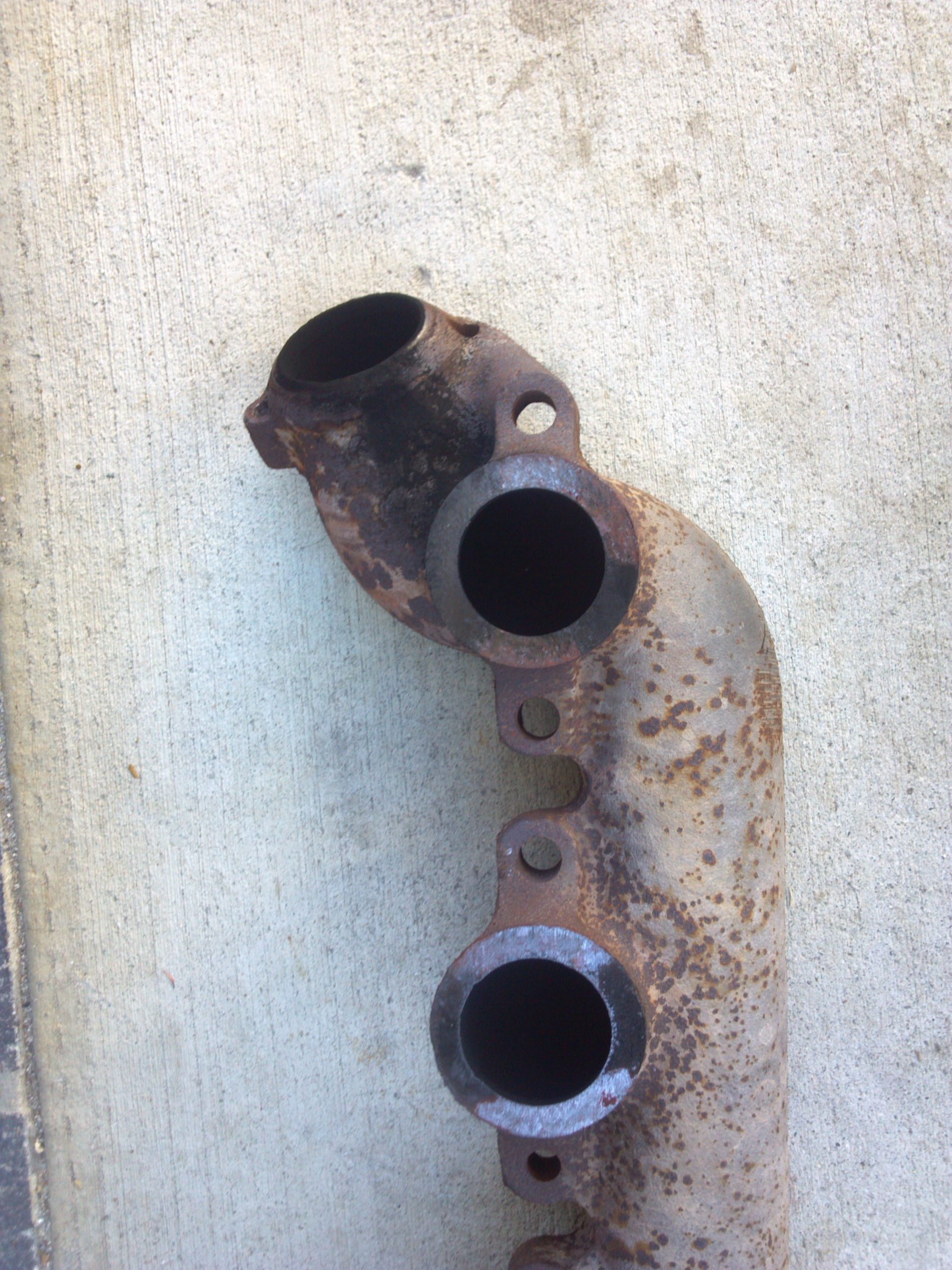

I finally got the driver's side manifold replaced. It took two hours, start to finish. I love living on the west coast, no salt on the roads! None of the bolts were stuck. The uppipe was leaking at the joint, ironically that was rusted/deteriorated and causing the leak and three of the four cylinders were leaking. First start up and I could hear a difference. The passenger side is next.
The Dorman manifold is well made and appears to be the same thickness as the OEM. Weight felt the same and all of the holes lined up fine. It's a good alternative to OEM if you are looking to save some money.

The truck is so much better with the leaks fixed. It's amazing The difference this makes. Check your manifolds and up pipes!

To find the leaks look for soot at the joints.
Quality is good.
