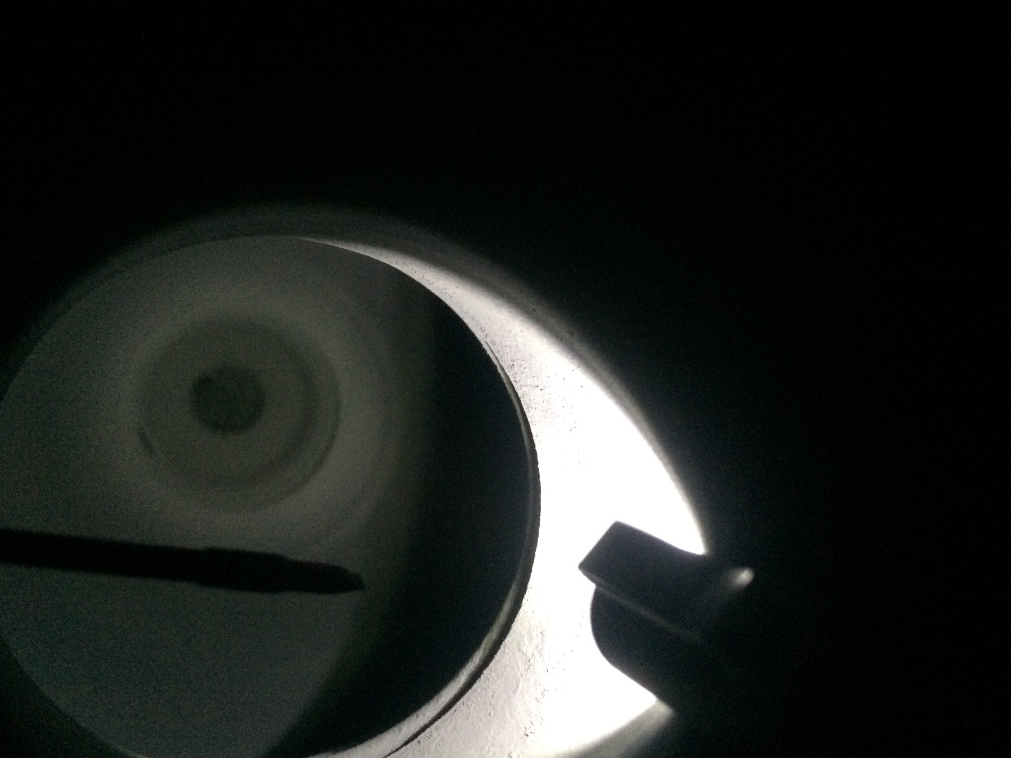

I bought this truck from a dealership and it has the stock exhaust on it, it is tuned. So I took the exhaust apart to see him it was hallowed out and when I looked down into the dpf there was nothing there just a hallow pipe and a couple prob sticking threw. Does that mean it is hallowed with a dpf delete tune? The attached image is a picture I took looking into the dpf

if it runs fine without saying reduced engine power and a check engine light, then yes-it is a delete tune.
