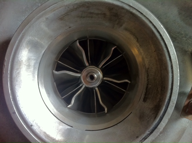

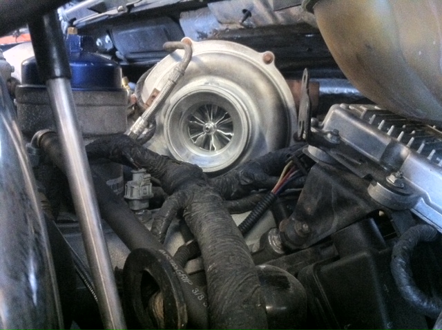

We just got finished testing the new batmowheel from bullseye this is a direct replacement wheel for 03-07 6.0s
Our test truck has a 190cc injectors and suncoast trans with a 03 turbo
stock numbers: 482.1hp @760.2ftlbs
Batmowheel: 493.5hp @867.8ftlbs
Back pressure& Boost
Stock: 42psi&36psi
Batmo: 42psi&38psi
Truck has alot more mid range power than the stock wheel and the spool up is alot better than before it also helped getting rid of some of the smoke from the 190s down low
We have the wheels in stock and ready to ship $399
Powermax numbers with batmowheel coming tuesday

Thats a really impressive gain. Anyone thinking of a powermax but doesn't wanna spend the coin to get it should look into this option also.

what about the exducer? does it stay the same or does it need to be re-balanced/upgraded?
Same size and no it does not need to be rebalanced
I plan on a Powermax when my stock turbo takes a dump, so if I get this wheel for my stock turbo now, will I be able to use it in the Powermax later? Those gains are impressive for the money.
the powermax wheel and the stock wheels are diferent so no they wouldnt work
any difference in EGT's?
200 degrees lower
