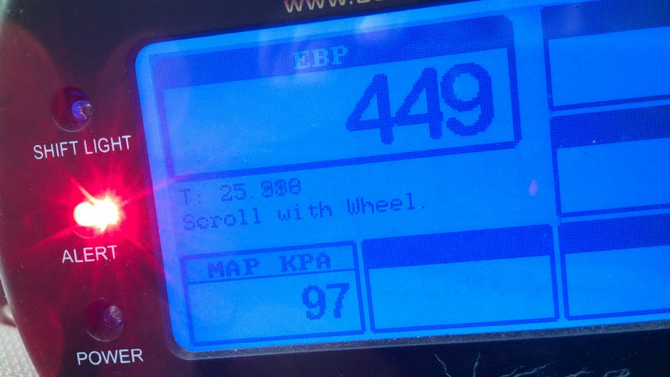

EBP is 449
MAP KPA is 97
Key is on motor is off

Yeah. Pull them and give them a quick cleaning. Might get everything working for cheap. If not the sensors need to be replaced.
On edit. When the EB sensor is out, take the tube off as well and make sure there is nothing in that too.

Cleaned the EB sensor it was completely packed full of black soot, im still getting the same readings, but the truck seems completely different its running a hell of a lot better, im just not sure why im getting the same readings
