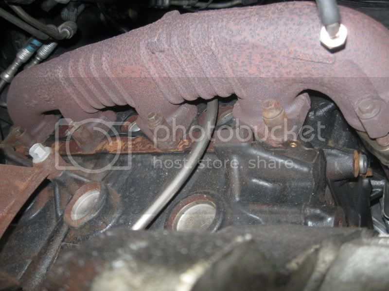

best place to put the egt probe to get the most accurate reading? all the help is appreciated!

Drivers side manifold, you can see where mine is in the right. Ideally you don't want it directly in front of a single port, but you do want it behind as many ports as possible to get an even reading. I put mine right towards the bend in the manifold. Also try to make sure it's angled so it's in the center of the manifold, don't want it touching the sides or anything obviously.

be careful when u tap it
NPT taps are tapered and if you go to deep the taper of the fitting will not tighten up in the taper of the hole
