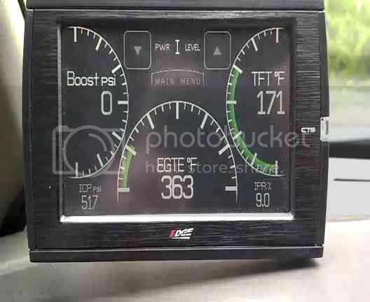

What would cause erratic ICP at idle? Erratic might be a bad choice for words but that's all I can think of! At idle, monitoring ICP with my CTS it bounces from about 460 to 490. The truck will hiccup and when it does ICP drops to a little above 320. The hiccup can barely be felt. It's almost like a miss. Doesn't happen very often and I first noticed it later on in the day on the 4th after an oil change. Running valvoline 15w40. Possible dirty IPR? Any ideas?

Take a peek at the IPR % to see if the PCM is commanding the drop.

Crap...forgot to mention. Percent stayed the same with no changes during idle. I think it was about 10.2 or 8% during idle. Only mod is an intake.

Here's a quick video of it happening. When it gets below 400 for that split second is where the "miss" is felt. Gonna do some inspecting tomorrow weather permitting.
