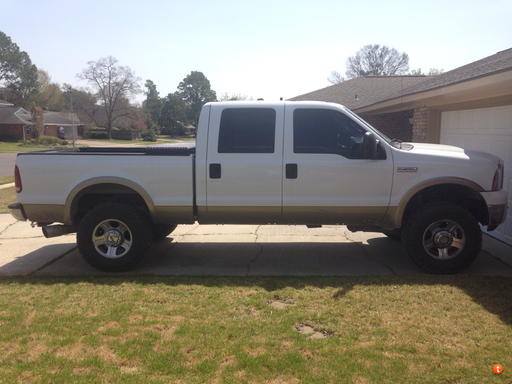

Does anyone have pics of an F-250 with the stock rear block and a leveling kit? I've currently got a 2" bottom mount spacer and 3" rear block, but I'm going to switch up the block...and will probably end up going to a smaller front spacer as well.
Just looking for pics right now. Thanks in advance.
Jeff@Spartan
5,409
Georgia
No. Just looking to be level at stock height. That's why I want to see pics, to see what size front spacer looks best with the factory rear block.

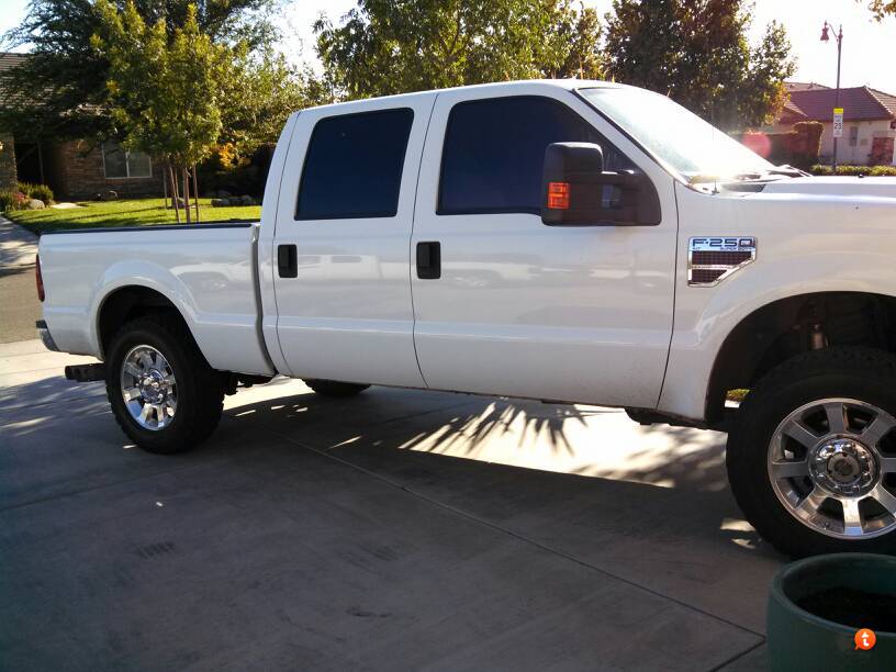

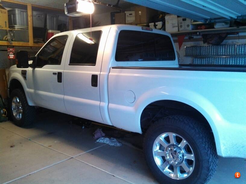

lngwca
Dec 31, 2012
24
Visalia, CA
F250 block
1.5" ready lift bottom block
Sits level. But the actual space from tire to fender is larger in front. Just the way ford has the wheel wells "offset"
Wish I had a better side shot

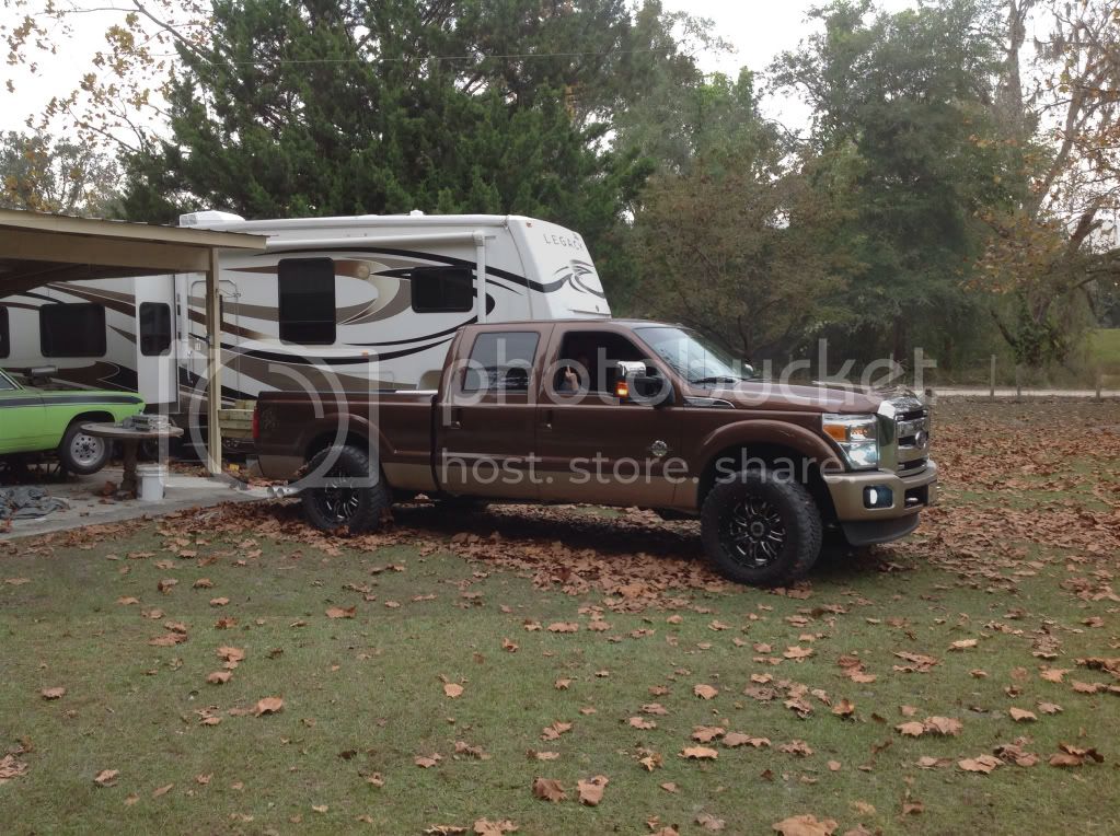

RedRice589
Dec 12, 2012
6,079
Ocala, Florida
They are nose high a 1'5" block is perfect I think
That's 2.5 in front
And with 35's
I'll keep the non helpful "leaning" photos to myself!!! :hammer:

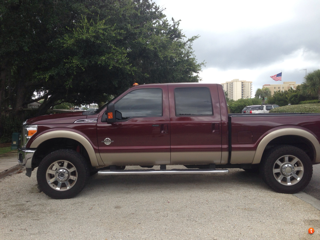

redracer62
186
Arizona
Thought these trucks would be way nose high with just the front done. About to order a TGC 2.5 kit
My truck with a 2.5" spacer in the front was way too nose high for me. About a 1.5" spacer would work perfect to make it level.
