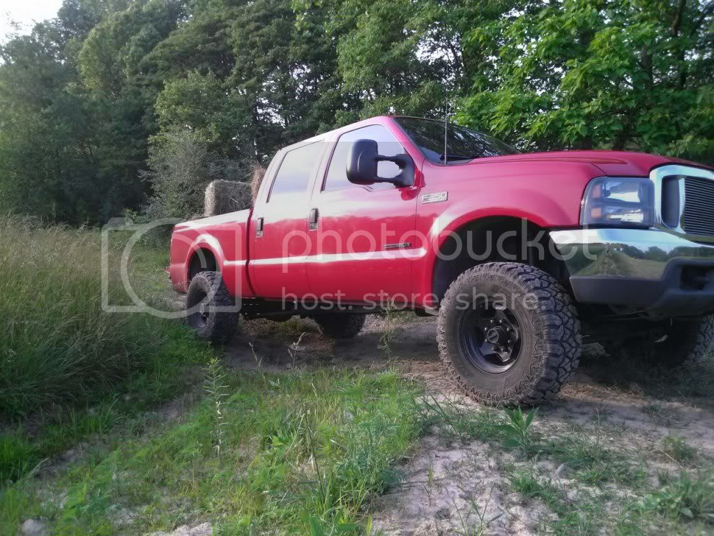

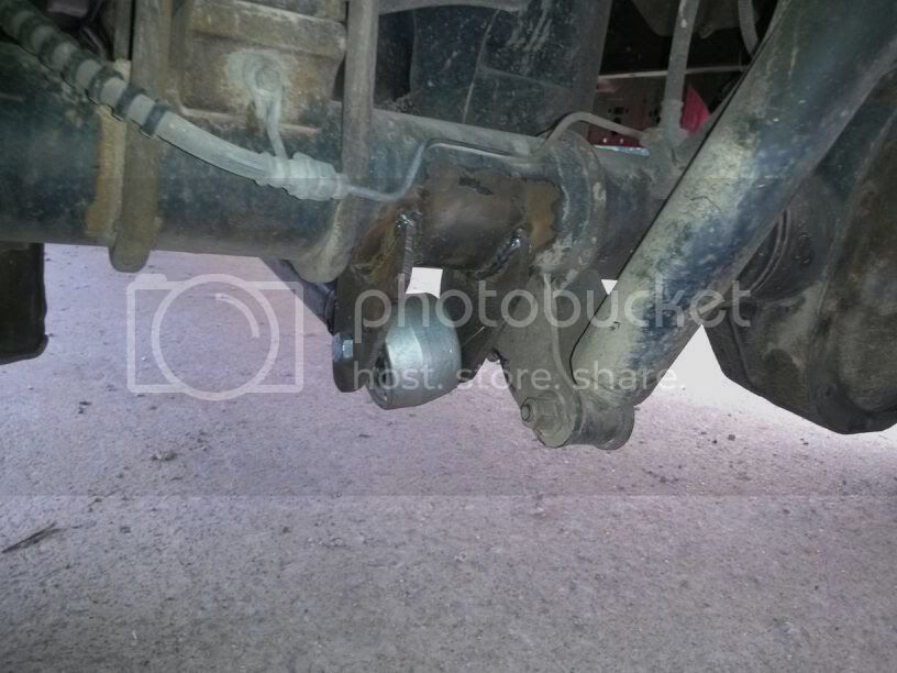

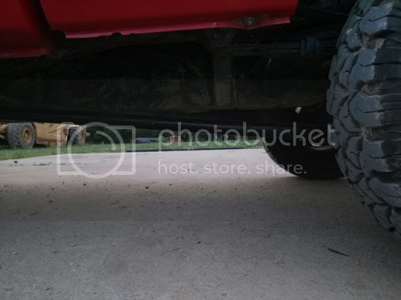

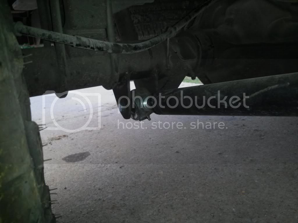

After several months of slowly working on them I am done. Ends are from Ballistic but can be found at other places. Bars are 2" DOM tubing. 72" long from eye to eye. Coated with rattle can paint for now, soon to get powder coated. Here are some pics kiddos........

Yeah I drew up the axle and frame mounts using solidworks and just gave them to a guy at work and he cut them out with is laser cutter. I just welded them together. The files are at work tho. Ill have to get them on tuesday.

Looks nice man. What are you using for the connection points and where did you get them. May kinda copy you this fall.
young7.3
1,308
Southern Indiana
The ends are ballistics 1.25" busshings and joints. I dont have any more pics of the underside flexing unless I pick it up again.
