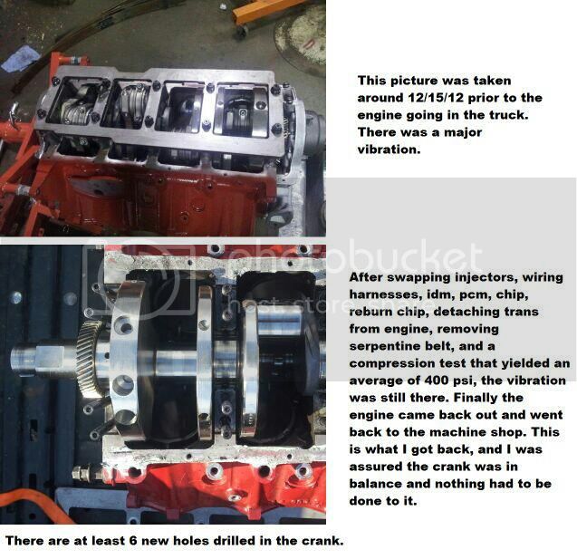

I had a engine built. Ever since it was finished it had a vibration. We pretty much narrowed it down to the engine. The machine shop guy is pretty much blaming everyone else. He even thinks we used a different flex plate than the one we gave him. He made me take my truck to his guy and he said it was not a balance issue it was bad injectors. Had them sent out and really done still it vibrates.

Yesterday the machine shop said the balance was perfect. No drilling was needed. He even took to second balance person to confirm it was correct. He still says we used a different flex plate and still blaming us.so I called him up and told him he was lieing and I had proof.than he says yeah the balance guy did redrill crank.so I had someone call the balance person and he said he never touched it.both are lairs.

So they basically didn't balance it the first time, and it needed to be? Then they checked the balance the 2nd time, said it didn't need balanced and that they didn't touch it, but they drilled holes in the crank? Now they are saying that its your fault that they didn't balance it correctly the first time?

Pretty much we think it was not even balanced the first time. In the top pic it clearly looks like a stock crank. When the machine shop took engine for the second time they told us the crank was perfect no balance issues. They did not have to drill it. When I told them I had pics of before & after both there stories changed . Balance guy told me he had to touch up crank with the new/ different flex plate we provided. That was that same flex plate from the very beginning there are still trying to say we used a different flex plate each time.
