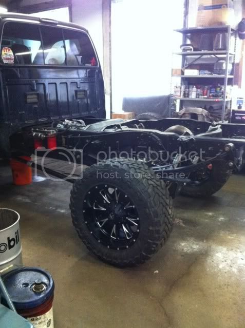

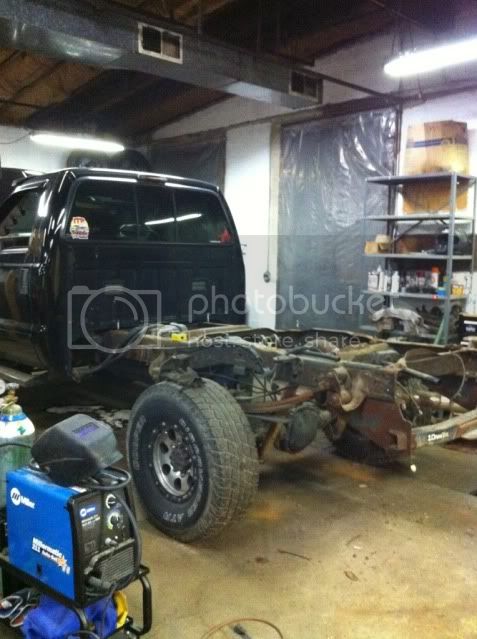

Powdercoating the frame would not be cheap! I would scrape/wire wheel what you can. Treat the frame with a phosphoric acid, I prefer SEM RustMort. Then just topcoat with a rust preventative paint, I prefer SEM Rust Shield. I brush it on so I can get a decently thick layer and it levels out nicely. I don't drive it in the winter so I can't give a good review about how it lasts in that condition. But it is holding up extremely well otherwise.
I started with this:
And ended with this:
