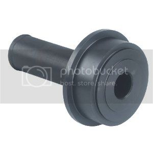

You have to pry the axle out. The hub seal is holding it in. That's the one you see behind where the bearing assembly would be. The other seal is a dust seal. They usually recommend replacing the hub seals if they are removed but being manual hubs you could get away with reusing them if they aren't shot. Also requires a special driver to get them on if replaced f you want to do it correctly. Some people make their own.

Prybar between the inner axle shaft and housing to remove..and that super nifty tool to install new seals on stub axle - and to install axle assembly into steering knuckle. You will be hating life if you try to do it any other way.

Ford will probably charge you $600-800 for the job. They're not pressed on, you use a BFH and that special tool. Most dealers will loan them out if you ask nicely. I know my local Ford dealer has 2 of em sitting on the parts dept shelf right up front.

You can make your own seal tool instead of buying/renting one. I used a pipe nipple, end cap, and a floor flange. You will have to grind the flange to the right diameter to fit inside the seal. I think I spent <$10 and about 15 min. grinding. If you like I can get the pipe size you’ll need.
EDIT: Here is where I sole the idea from; http://www.superdutypsd.com/ball_joint_article.php
