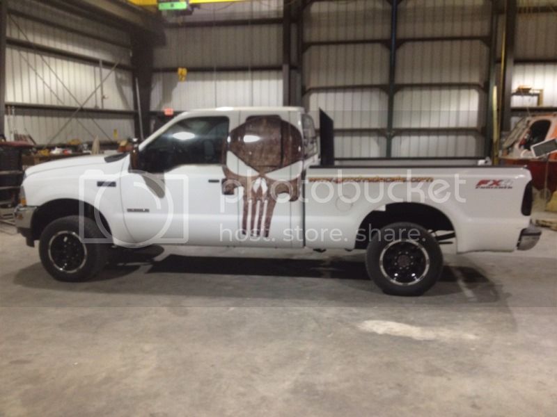

This is my old truck with the rear block removed and stock leaf springs up front:
imelmo
6,633
17x9's. I don't remember the tire size off hand but iirc they were like 29" diameter.
imelmo
6,633
So let me be clear. Your front springs are v codes and no rear blocks?
I don't know what the code is, but they are the stock springs that came on the truck (late '04 truck), and no rear blocks. I did nothing to the front.
