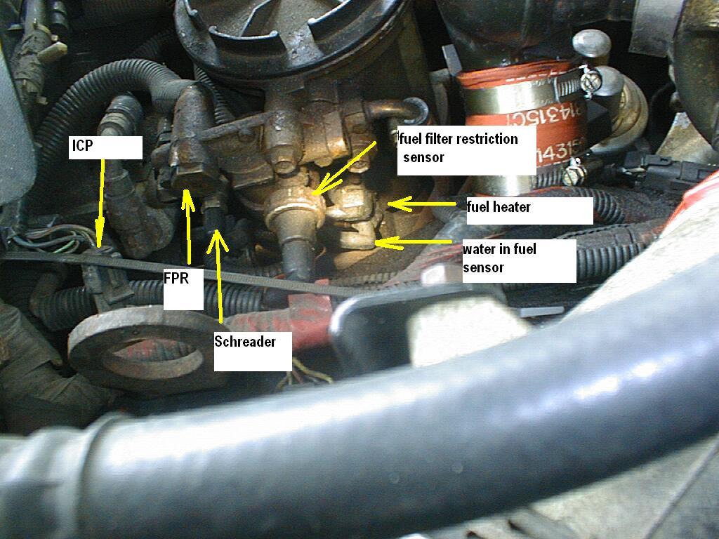

1) The fuel is leaking on the side of the fuel bowl, It's a small line that runs into the side of the bowl into a round fitting about 5/8". My question is; is this something that just requires an o ring or will I have to buy a fitting?

I may be able to get a pic of the fuel leak later and will post to make this a little easier lol. Thanks for any advice y'all have

[/IMG]
Here's the best pic I could get of it with my phone.

The "round thing" on the fuel bowl you should be able to unscrew it and wrap some Teflon tape around it and screw it back in.

You need to pull the engine to reseal the oil pan with RTV. I believe what is leaking on your filter housing is the restictor sensor. If it is you can just pull it out and place a 1/8" npf (I believe) plug into it. But if you do don't tighten it too much or you will crack the housing.
Here is another picture to make sure of what you are talking about.

Definitely the restrictor sensor, the pic made that a whole lot easier. That does away with one problem, I just have to find time to get the oil leak fixed now.

Got the fuel leak fixed, had to make up a plug and delete the sensor. Tried taping the threads and it still leaked so I just went the other route.
