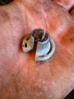

Anybody know a better tool than this for the fuel lines? Maybe some tips?
Thanks!

Cut those stupid things off and replace them with a short piece of 30R9 rated fuel injection hose and some hose clamps. Those things are just not worth fighting.
Zaairman
Sep 1, 2011
826
Wright City, MO
The metal tools work much better. They're available at Sears, Harbor Freight, any auto store, etc. Spray out the connection with Brake Cleaner, only get the kind without chlorine. That'll get most of the gunk out. You've really gotta get them in right, the fittings are a pain in the ass. If you're trying to get them off of the fitting right under the motor, good luck. They're the hardest due to they amount of road grime they get in them.
