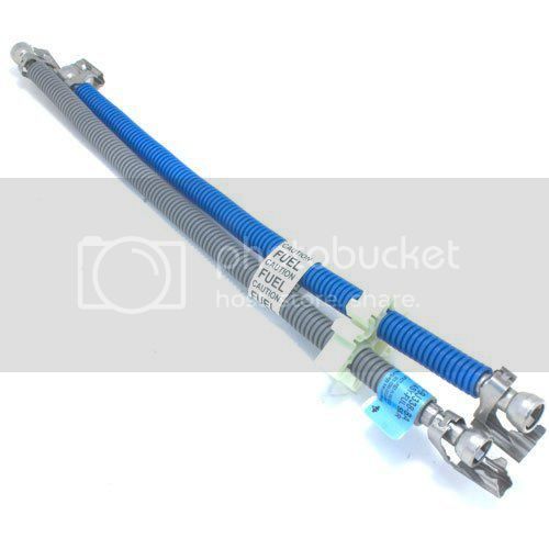

Can anyone give me a part # for the flex lines between engine hard lines and chassis hard lines? According to my local dealer they don't exist.
BigAlsPSD
Aug 16, 2011
533
Pea Ridge, Arkansas
Assuming it's a super duty, the flex lines are P/N 2C3Z9J338BA, like $175 MSRP though, I would just install 30R9 fuel line personally.

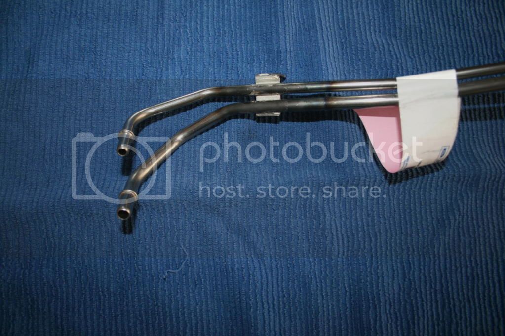

And just for future reference the P/N's for the hard lines(Feed and Return) on the motor are F81Z9J338NA around $130.
