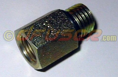

It is m12x1.5 oring. I have an autometer adapter and I had to grind it down for clearence. Another option is a billet filter cap with a test port.

Are you talking about the fuel pressure adapter fitting that connects to the fuel pressure adapter hose/line for the mechanical gauge set-up? That fitting won't connect to the 1/8" NPT threads on the pressure sensor.

I don't have a picture but it is a m12x1.5 thread to a 1/8npt in the test port on the regulator housing. Where do you have your mechanical gauge taking its reading from?

Found this pic on google. You screw it into to test port and the gauge into the adapter.

I've got the fitting in stock for the test port to run a hard gauge, or to adapt it to 1/8 NPt for a electronic sending unit
