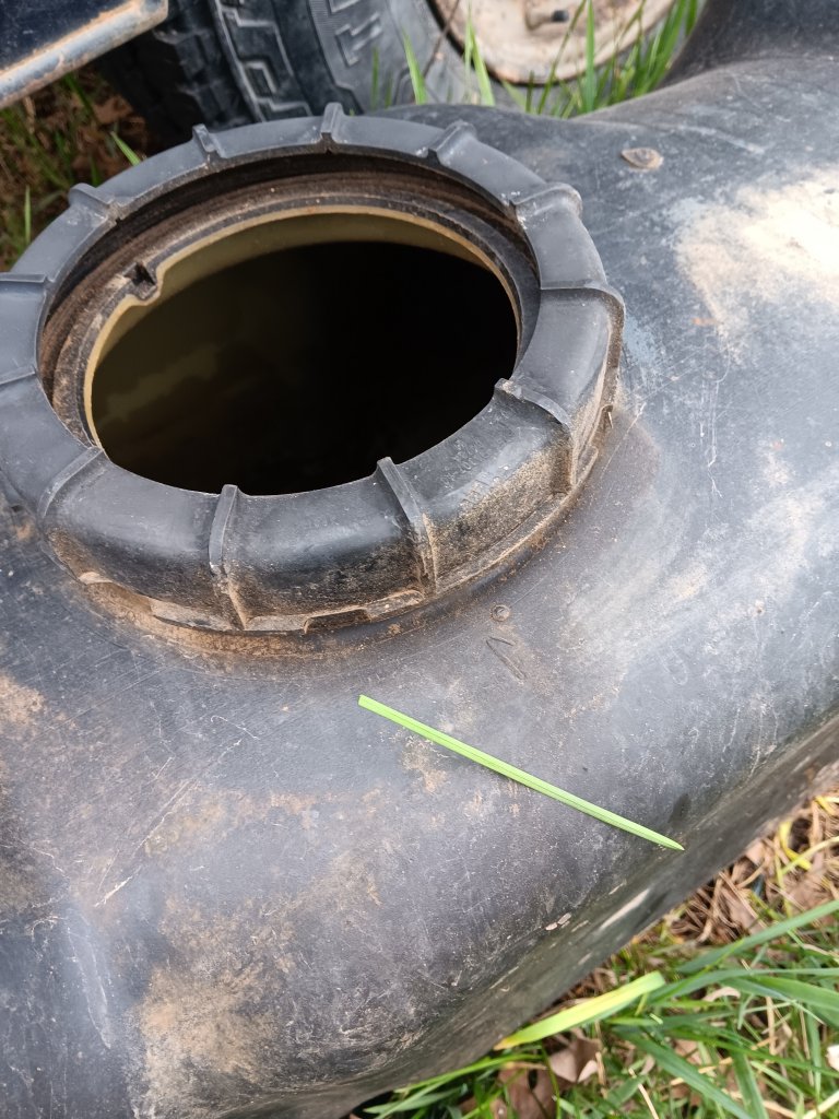

What is the process of removing a fuel sending unit out of a 2001 Ford F-350 dually that has the midship fuel tank and on top of that I forgot to mention It has 105 gallon fuel tank in the bed that's connected to the factory tank and what is the process to remove a broken wheel studs?

Drop the tank, disconnect the wiring where it plugs into the frame harness, and disconnect the fill and fuel hoses.
The fuel hoses take a quick disconnect tool, should be 5/16" or 3/8".
Drive the big plastic nut off with a hammer and punch. If you're careful with the gasket, they are generally reusable.
Front or rear wheel?

What do you mean by front or rear wheel? Are you talking about in front of the wheel or behind the wheel for the gas tank location?
