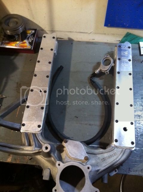

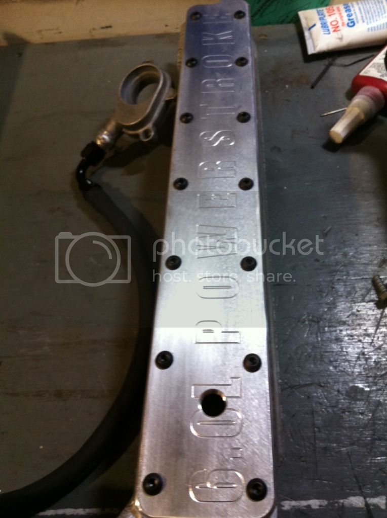

Here is a partial review. I haven't got a chance to drive it alot yet. Quality of his manifold is very very Nice! The welds are smooth and the top runners give it a nice touch. The inside is completely removed and smooth. Install was easy.
Ive had high egts with my powermax and warren 175/75's and this helped it out alot. Cruising 40-50 I was 650ish now im around 500-550. Wot I was 1,600ish now it's around 1,350-1,450. Haven't had a chance to cruise on interstate yet. Throttle response has improved. It's alot smoother driving and shifting.
I will post more as I drive it. I have some pictures if someone will text me and I'll text pics back.
Thanks!

I'm a big fan of the Gogo intake. Send me a PM, I'll send you my email addy, and post your pics up.
Just wait till the first time you're stuck behind someone on a 2 lane road doing 50 mph in a 55 mph and decide to pass. The grin will be ear to ear.

I have sat with Doug for hours as he makes these manifolds. The quaility on these pieces are second to none. They are all done with a cnc. The right way. No warping of any kind. I know mike (snake) can vouch for any products that Doug puts out.

Indeed! I also had a chance to spend a day with Doug while we were putting mine together (and working on others).
The effort put into making these made me go
