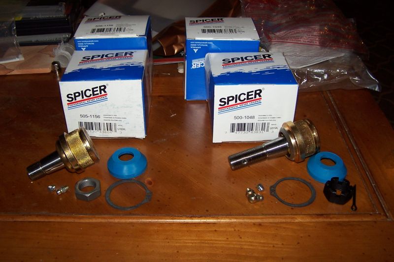

i also have a tiny bit of play in the ball joints on the passenger side. I'm going to replace them but am trying to decide on XRF,moog,spicer,MCQuay Norris,ingalls engineering... im going crazy who makes the best ball joints? besides dynatrac... lol

so raybestos = spicer = MCQuay Norris
"Affinia Group Inc. is a global leader in the on and off-highway replacement products and service industry. In North America the Affinia family of brands includes Wix® filters, Raybestos®, AIMCO® and BrakePro® brake products, and McQuay-Norris® and Raybestos™ Chassis parts. South American and European brands include Nakata®, Filtron®, Urba® and Quinton Hazell®. For more information, visit www.AffiniaGroup.com."
MadDiesel73
1,153
Glen Burnie, Maryland
Raybestos - pro grade lower 505-1181 ~$55 lifetime parts/labor warranty
pro grade upper 500-1048 ~$45
McQuay Norris - Extreme duty lower FA1754E ~$55
Extreme duty Upper FA1171E ~$45
New Spicer lower 505-1181
upper 500-1048
Old school made in usa OEM DANA/Spicer Upper and lower kit 700238-2X ~$90
XRF 4pc 2 upper/2lower ~$100 / million mile warranty
The xrf ball joints as well as the raybestos pro/MN extreme/spicer pro us a full ball design with a synthetic bearing.
XRF -
Raybestos/spicer/MN
