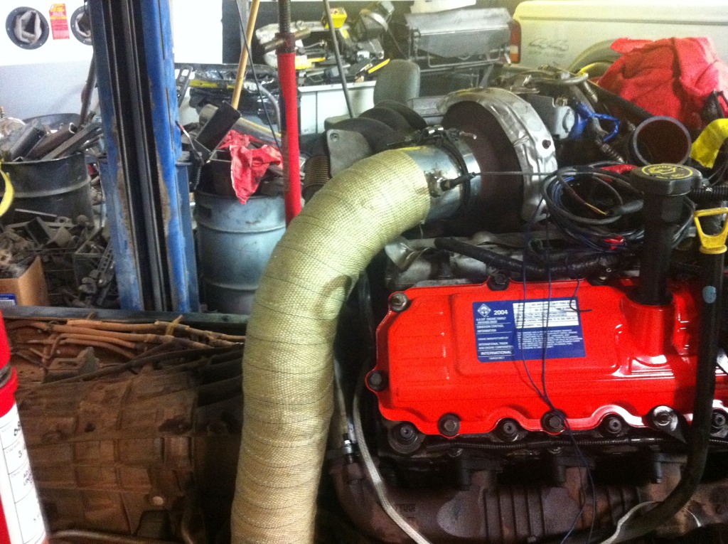

I wrapped my down pipe, I have no issue with it holding moisture. ImageUploadedByTapatalk1359433492.687037.jpg
And since I had it laying around it was free
