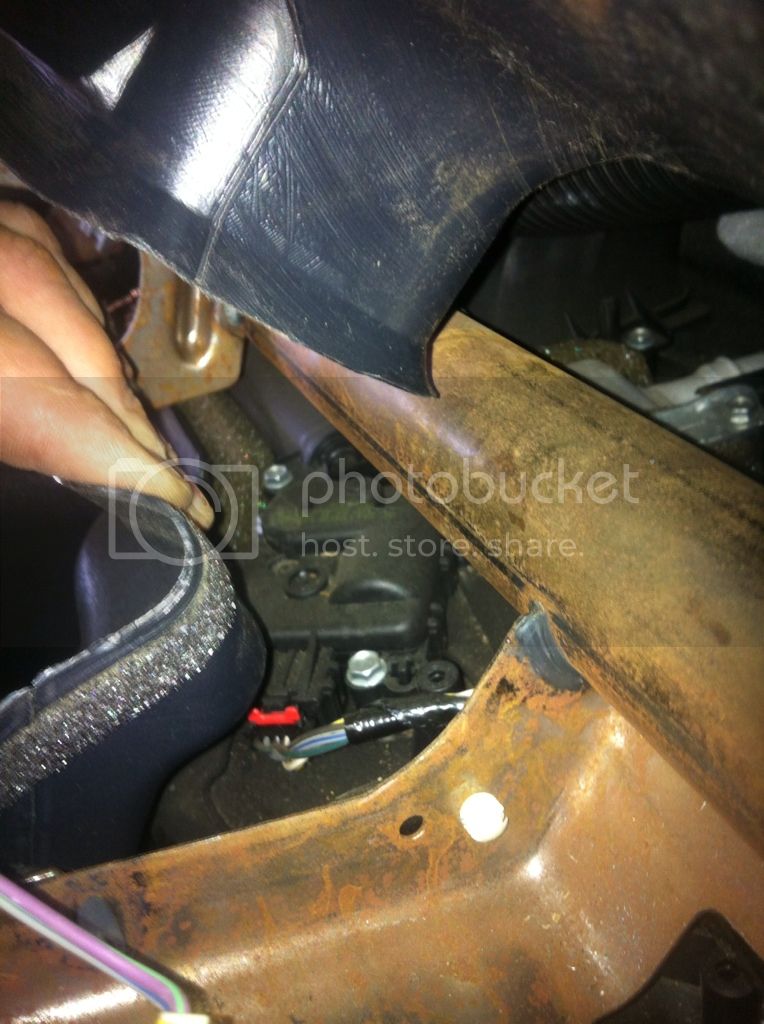

Job complete.. The hardest part by far was getting that center vent elbow out and back in..time like is about right.. 45 mins to get it out And I took me time putting the dash back together
1tonpower
Sep 22, 2011
170
It can probly be done the same way.. It will be tricking getting the drivers side center vent pipe pipe out... There's not a lot of room to slip the cross tube off. You may have to take the gage cluster out to. To do the drivers
Side the air bag and glove box wouldn't have to be removed.
This pix is looking in through the air bax area or the dash..the vent peace has been removed already..
