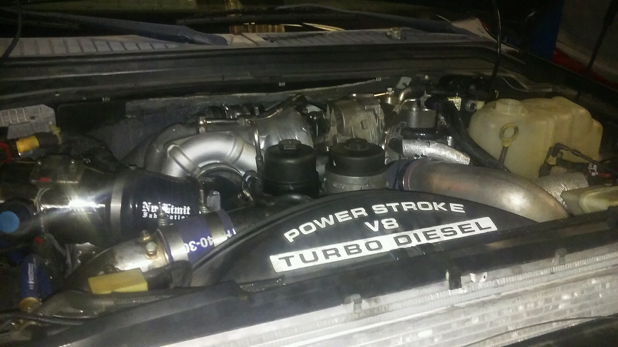

doing nozzles w/o a 2nd pump is depleting my fuel rail pressure FAST, even w/a Newer HPFP.. It's def going to need a 2nd pump (like u all say) in order to maintain fuel rail pressure at WOT if I want more/reliable power. So dyno stopped at 620+hp/1140+tq for today.
maybe I can order a tune to pull PW out til I can get fuel system up to par?
Mods: coated/de lipped Pistons standard bore, new balanced hp/lp wheels, 30% nozz, stage1 cam, SAD lifters, springs/retainers, pushrods, head job, wg, FTI tq, on stock rods/trans..

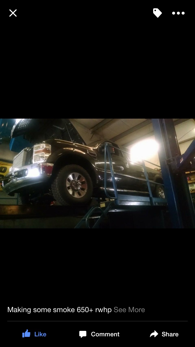

Bullseye Lp/Hp balanced wheel replacement. Plenty of fuel down low & No idk rail/pw.. Was just told it's not maintaining, last ran yielded 650 rwhp/1200tq. Trying to get a revised tune from GH to maintain rail until I get fuel upgraded.
