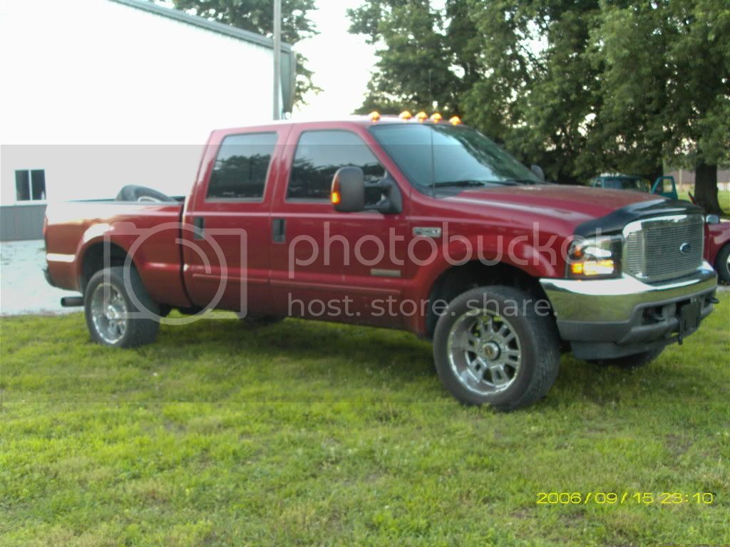

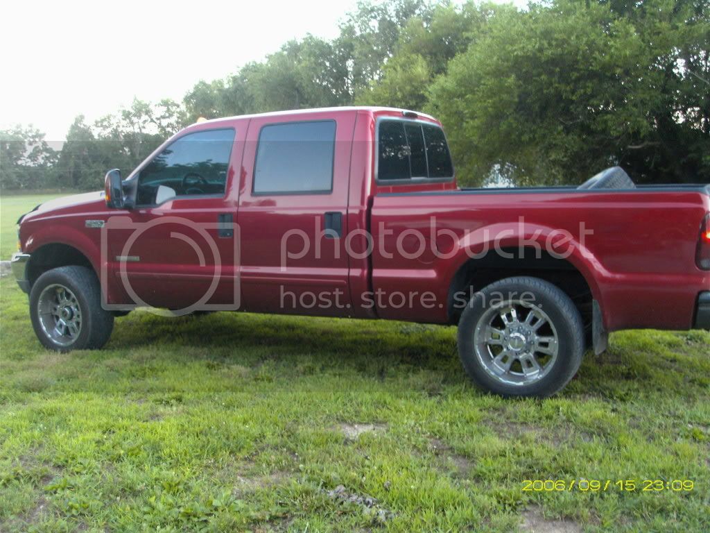

I'll see if I can find some pics of my old truck. I had stock F-250 springs up front and a billet 1" block in the rear with 20x10 and 305/50's. Looked pretty good if you ask me. No block in the rear and stock springs up front gave the truck a reverse rake.
Countryboy07
692
N. Manchester, IN
Here you go:
