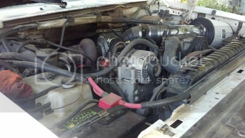

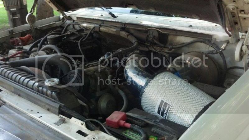

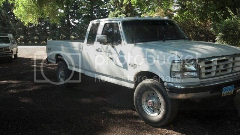

Found this truck on the nation 94.5 F-250 7.3. 265k with a ZF5. Guy took a pretty good video, just wondering what people with more knowledge think of it. It has some blowby which is expected, just not sure if it's excessive. Looking to pick this up for a good work/plow/just about everything truck

Truck looks pretty clean overall. Things you can expect to do on those year trucks and for the miles.
Ball joints, pack bearings, brakes, possibly rear spring hangers, most of those trucks that have spent ANY time in the NE will have some rust on radiator support, cab corners, and some over the bed.
That blowby was minimal. If he has no service records on the injectors, I would plan to do GPs and O-rings. With the miles all fluids should be changed front to rear.
In a nutshell, whatever the price of the truck is, I would set aside 2-3K more just to do normal maintenance for a truck of the age and mileage to make it more reliable. After you do that though you should be able to run for another 100k without issue.

where is the rust???? wow clean body compared to what I'm used to seeing. has the clutch been updated to solid flywheel?
overall a pretty nice truck, wanna sell the bed? lol
