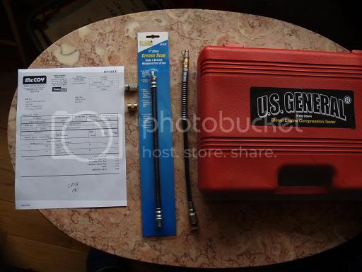

Your starting goodies-
An economy diesel compression tester. I know for a fact that the Harbor Freight tool #93644 ( 12 Piece Diesel Engine Compression Tester ) has the 1/8" NPT adapter we will need. So I recommend it.
You'll need a 1/8" NPT female-to-female connector (I call them barrels)
You can get the just about anywhere that has a brass fitting selection. I got mine from Parker Store as it was easier to get it at the same time as our next piece.

Here's what you need, plus an already assembled whip!

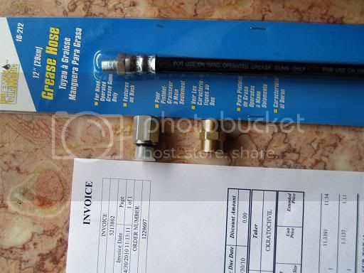

A closer look of whats required to make the whip-

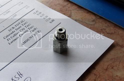

And a close-up of the kicker part of the setup- the M10-1.0 O-Ring Boss to 1/8"NPT female adapter-

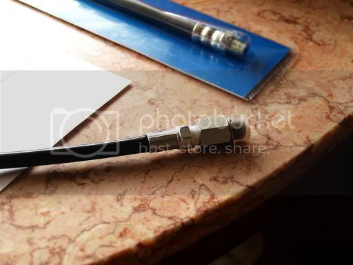

So. What you will need to do is either pipe-dope or teflon tape both ends of the grease gun whip. If you use the tape, make sure when you put it on the threads you wind it such that when you go to put on the adapters they will spin in the same direction the tape was wound. If you do it the wrong way, it tends to bunch up and not be too effective.
Once you've teflon taped up the grease whip, attach your 1/8" NPT barrel connector to one end of the whip, and the O-Ring boss adapter onto the other. Make sure you are snug, but don't go crazy. We don't want to damage threads. But also remember, your new compression fitting must withstand upwards off 500PSI. Thus the grease whip as they are usually rated with a working pressure rating of 3000-5000PSI.
Believe it or not, thats as simple as it is! You now have a compression adapter whip ready to accept the 1/8"NPT adapter for your diesel compression testing kit!

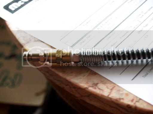

A view of the adapter side-
And here is a view of the barrel side, with the 1/8"NPT compression adapter threaded in-
