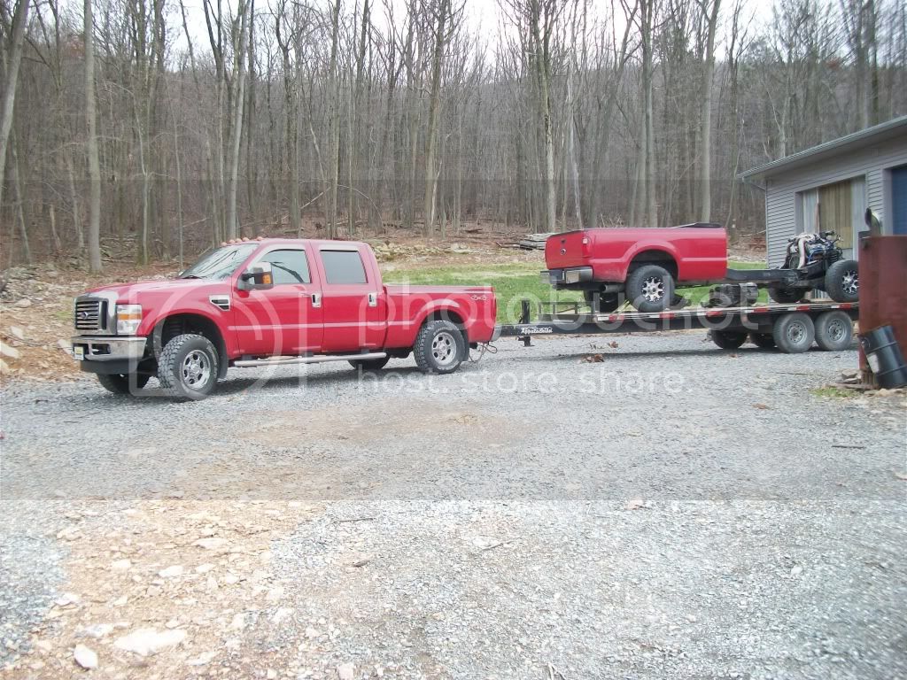

Well we started the teardown today, cab is up and the chassis is back to the garage to tear into the motor first thing tomorrow morning.

Well its finally all together, full build was the head gaskets, arp studs, Maryland performance 30% nozzles, Elite ported fuel rails, Elite wastegate kit. Already installed the airdog direct to HPFP a month or so ago.Also pulled the trans and clutch to put a new rear main seal in as it was damp when we put the clutch in. Going to work on some more testing and tuneing to get everything dialed in now. Here's a bunch of pictures from the build.
Ready to tear down
