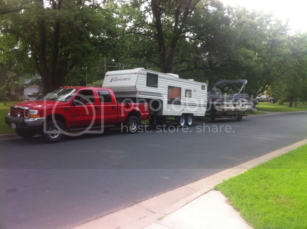

Easy as Pie. I installed mine with drilling 8 holes in less then an hr. A good sharp 1/2 drill makes all the difference in the world.
Also I'm not sure if my 5th wheel is speical or set back more then others but with my short box I would have to complete jack knife it to hit my cab corners.
Here is a picture of my rig.
