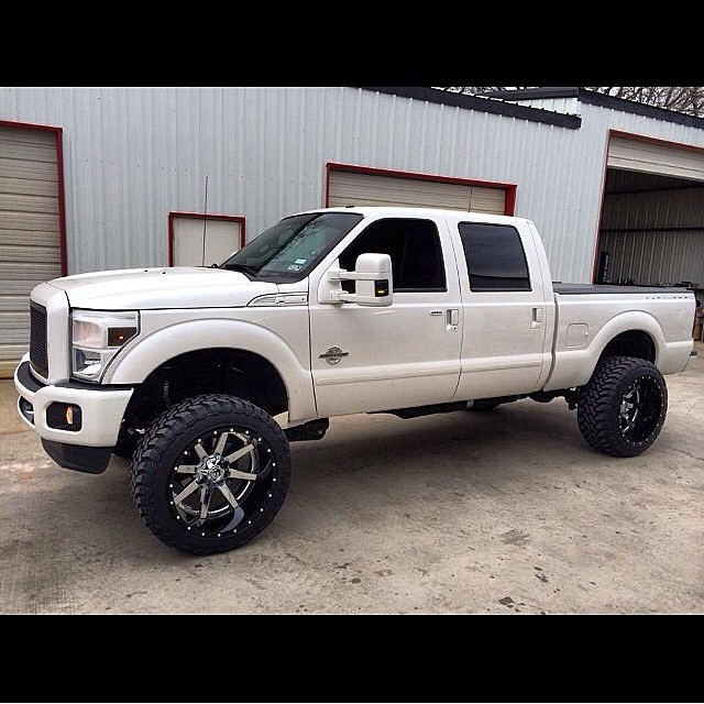

Trying to figure out if this is 6 inches of lift or less... 22x14's on 35's?

That was my initial thought but I dont know anyone that has been able to clear a 37 on a 24x14. My buddy put a 6 inch RC lift on 22x12 mavericks with 37 in. toyo's and had to bump it to 8 because the rubbing was so bad.

6" fabtech lift, 24x14 Fuel Maverick, 37x13.5x24 Toyo open country
I bet this guy's right. He may have a coil spacer up front, the truck appears to be leaning but that may just be the angle.
If you look at the back of the front wheel well, there should be fender liner much lower than where it stops. I bet they hacked what they needed to make 6'' work if there's no spacer up front.

that's my buddies truck. that's actually a 4" with a spacer on top, with 24x14 mavericks on 37's. it does rub at full lock

I was blown away after hearing that someone was able to fit 24x12's with 37's on 4.5" inches of lift. This truck is even more bonkers!!! :eek:
