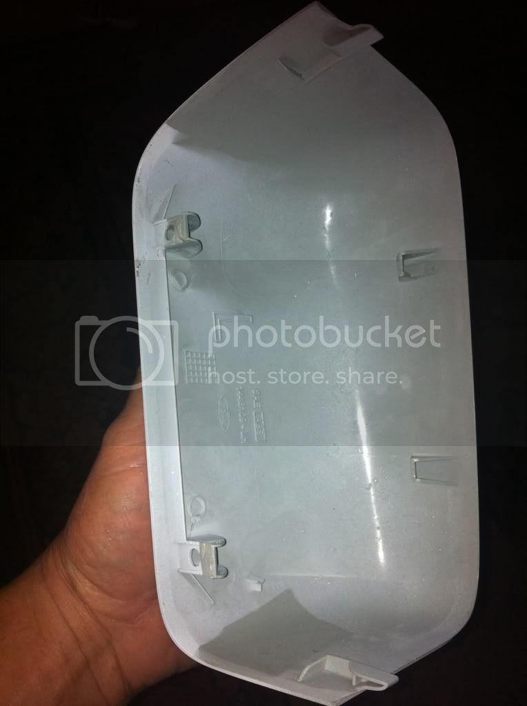

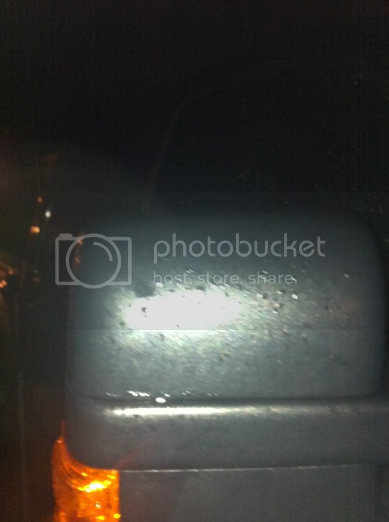

Here are three pics of a 08 and up stock ford mirror
textured cap
And one of the same next to a ptm one
And the back side of the caps. Both the same for the textured and the ptms
G Racing
1,643
Southeast Texas
Sorry for the crappy pics. It's raining and dark outside. Both the caps are the same size. The two tabs on the left with the holes are were the top latches together and needs to be released. I usually pop the mirror off and reach back behind with a small pick and push the latches away from the tabs and then the tops will come off.

G Racing
1,643
Southeast Texas
They look like they are one piece but there is a seam where it meets the upper arm, as shown in the first picture. They do come off and can be replaced with ptm ones.
