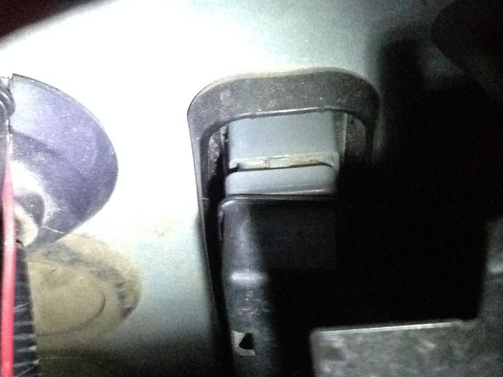

This is a picture of the PCM from the engine bay. Do the 2 gray parts need to be touching? As you can see they are still pretty far from touching and the bolt does not want to tighten any more and it feels like I'm gonna break the PCM every time I try to tighten it.
OBS73
Mar 4, 2014
263
Have u pulled the pcm and tried plugging it back in to see if you get a better fit. Or maybe if you bent some pins while reinstalling?

Yes it continues to show "LL" after truck starts and no it has 6 tunes from Gearhead.
OBS73 - I'm about to pull it right now.

Took everything apart, readjusted the connection from the chip to the PCM. Put it all back together and now it's displaying "11". Idk what else to do.
