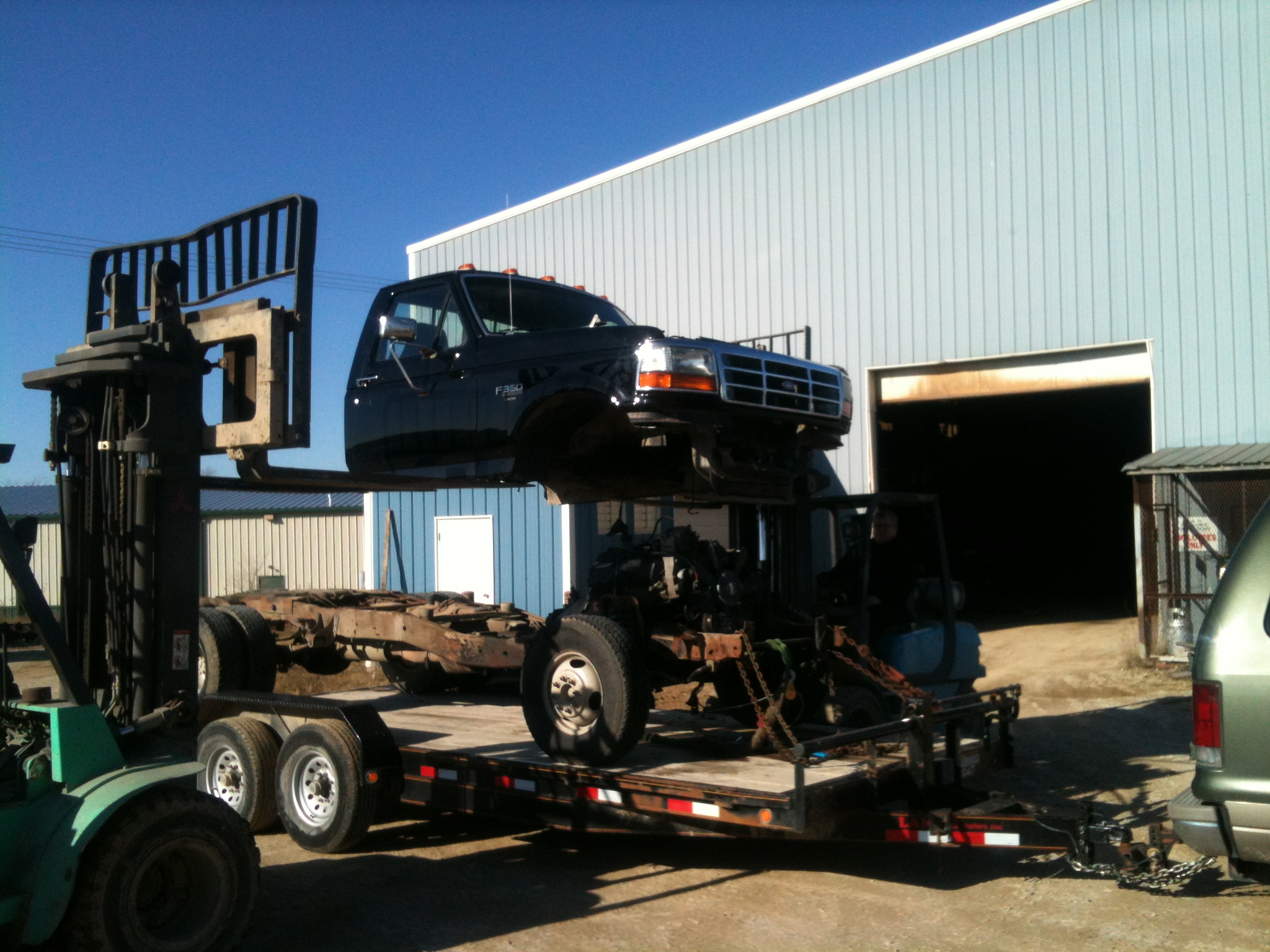

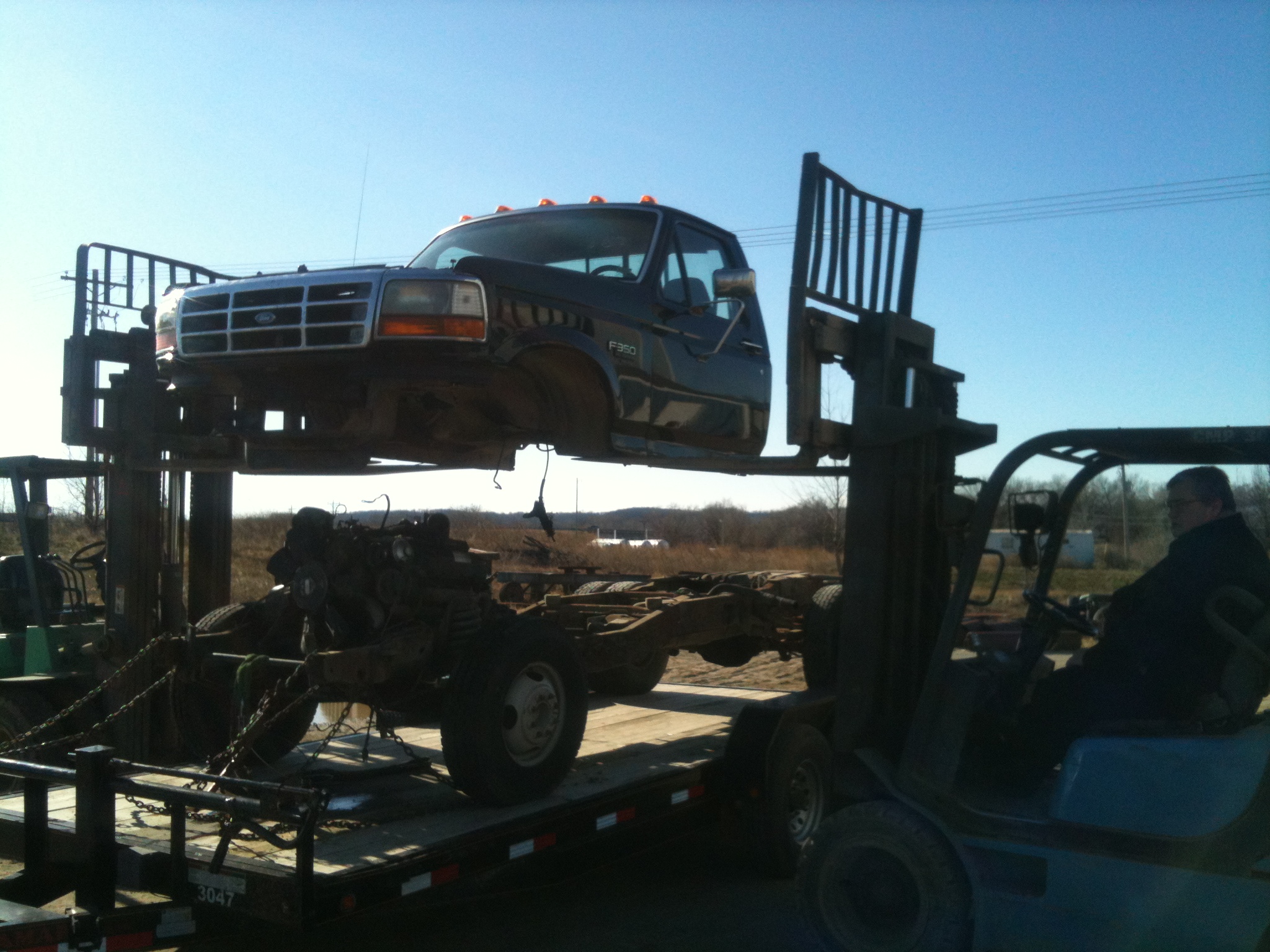

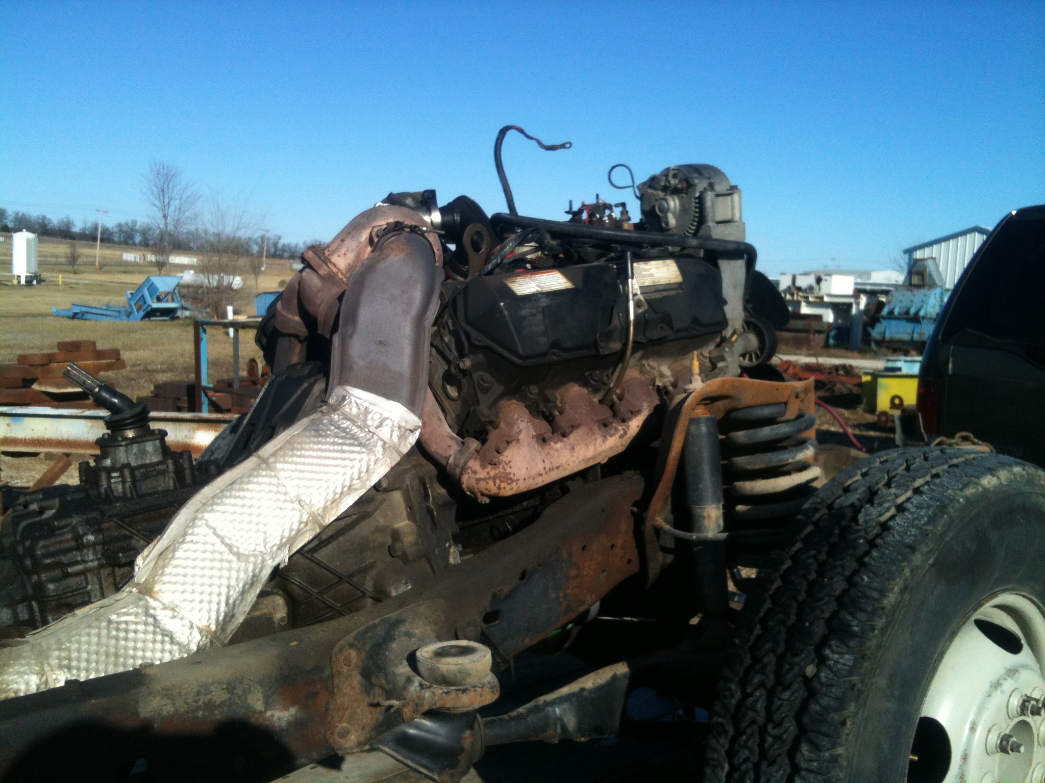

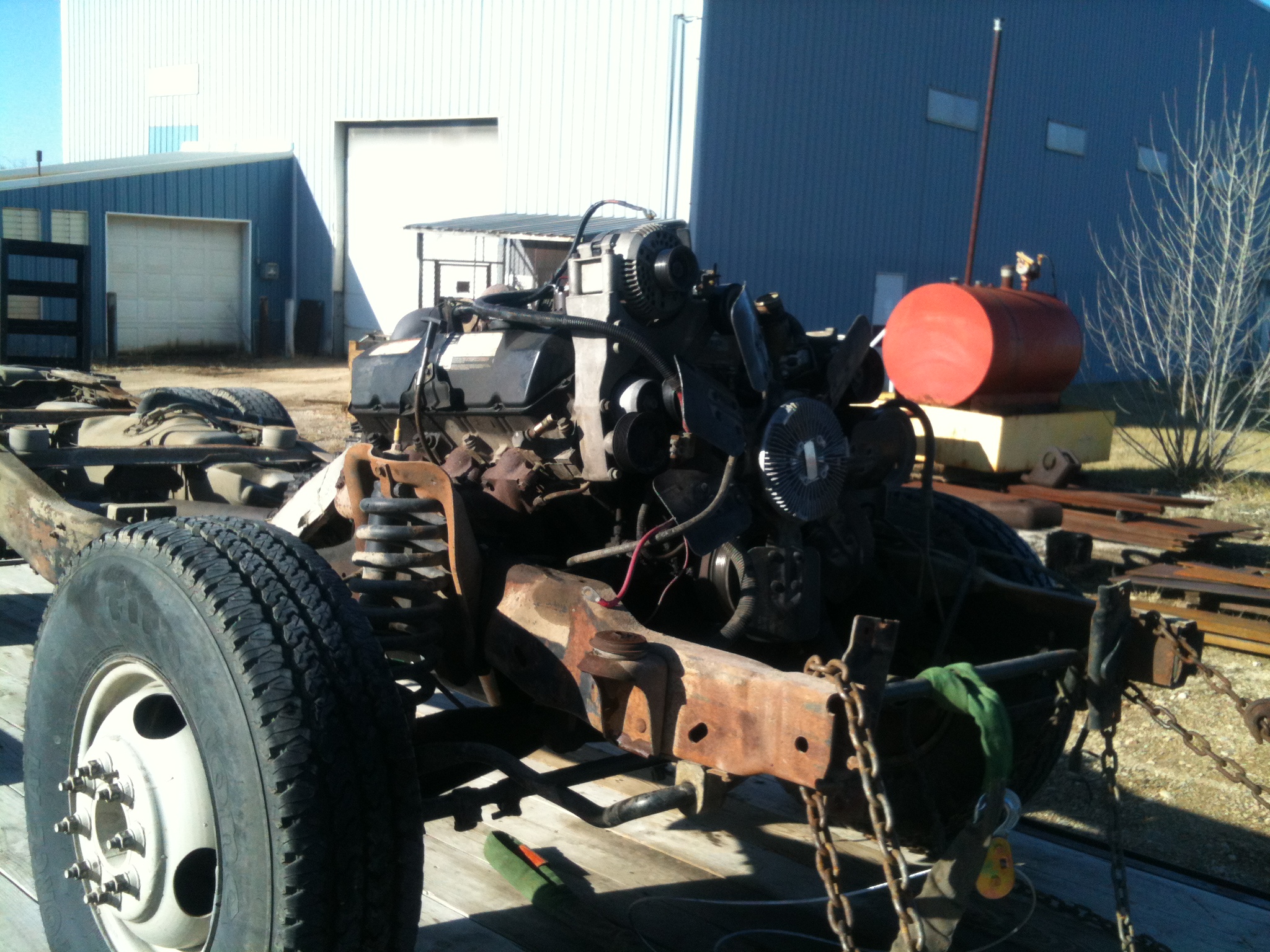

Well the cab is off and I'm very glad I did it. There were two electrical connections, steering shaft, brake lines, e brake, and a few other things that needed taken off, but it was surprisingly fast to do it. I spent most of my time fighting with the cab bolts becuase I couln't hold the wrench and impact wrench at the same time.
