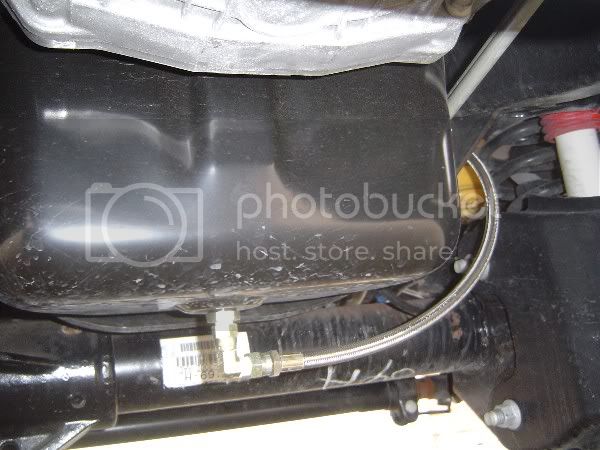

the fs2500 6.0 system I have has 2 options for the return one through the oil fil cap and the other into the drain plug of the oil pan
they also offer both options for the 6.4 http://store.fs2500.com/ford64f-250throughf-550enginekittopan-stainlessonly.aspx
I think theirs oil fill return works out because it places an adapter at the bottom of the oil fill tube against the valve cover?
I saw that but i couldnt find any good info on the return to the oil pan. Maybe ill give them a call

it just goes from the outlet on the filter housing into the drain plug location
so you have to pull it every oil change
