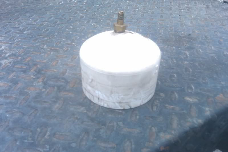

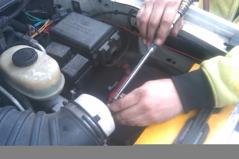

Boost leak detector:
PVC cap(s), a schrader valve, soapy water and 10psi of compressed air... :toast:
