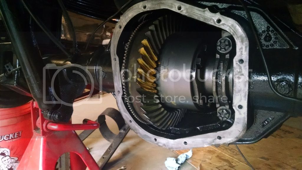

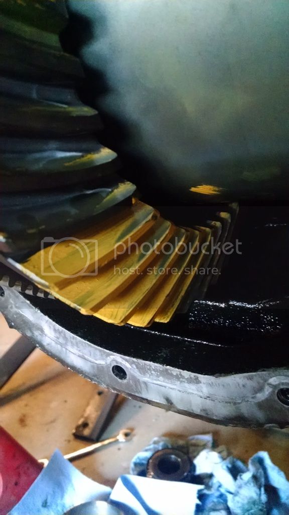

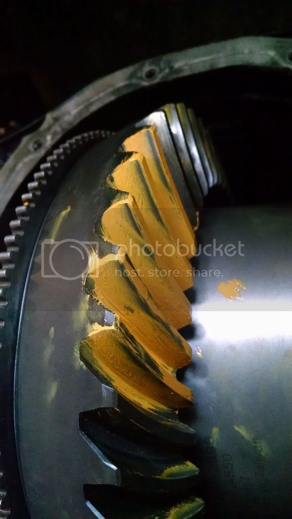

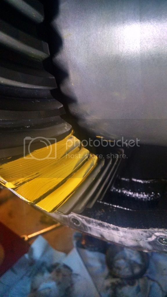

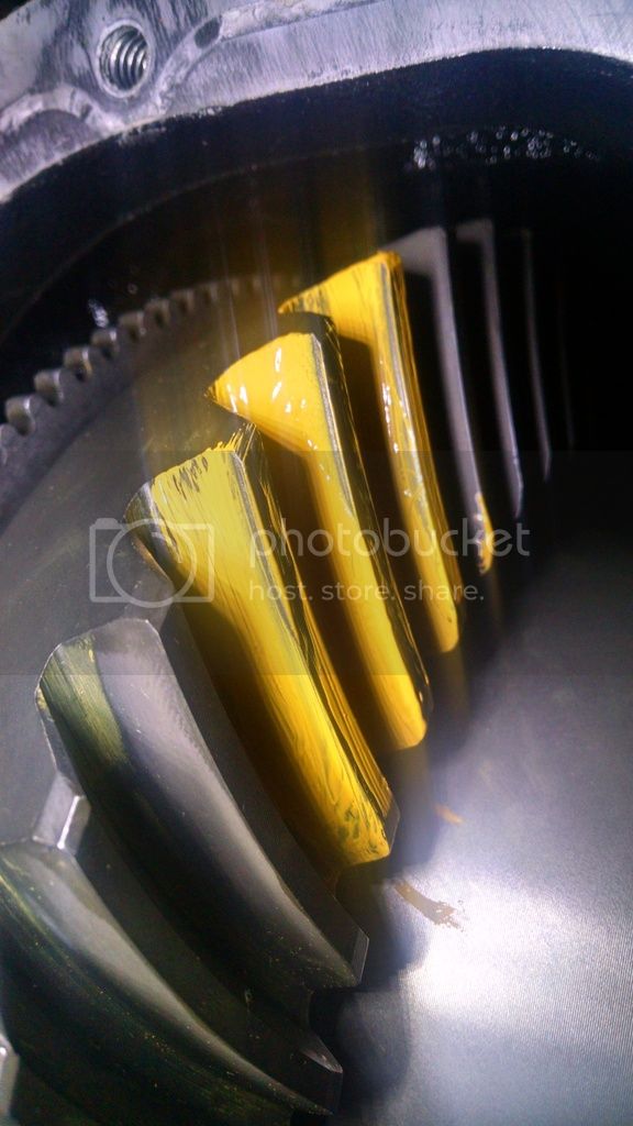

[QUOTE="blk350on20s, post: 1234279, member: 1550"] Shimmed the race in the housing out .120 then stock .030 shim behind the bearing. Shimmed carrier back towards the drivers side for a .010 backlash. Front and rear are all done. [ATTACH=full]153350[/ATTACH] [/QUOTE]
