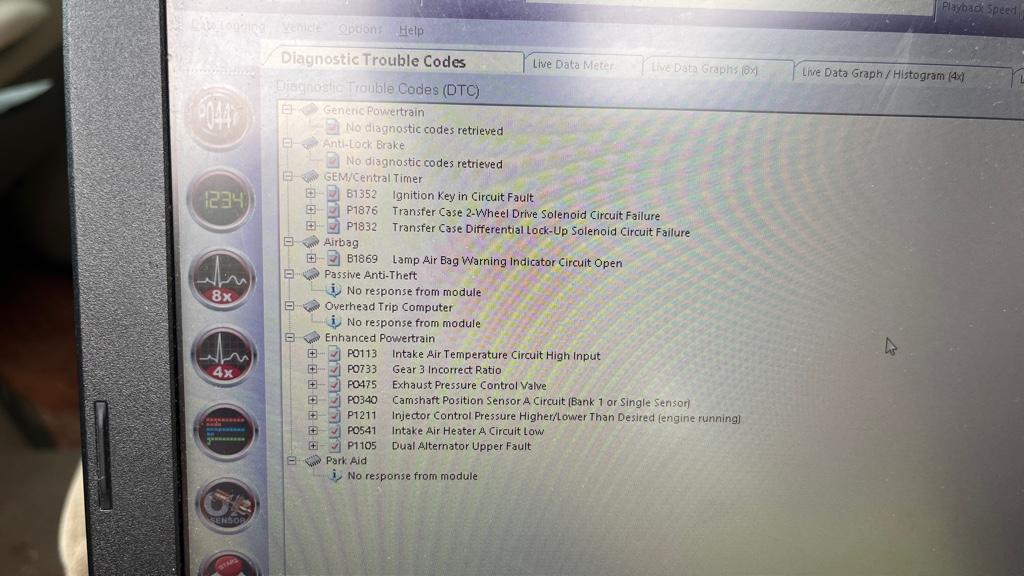

Anyone seen this before? Is this an issue with the ipr?
It could be the ipr, tuning, or icp. Is it something that just started happening, or did you make changes, such as injectors and tune and then it happened?
If it started happening with no changes to anything, check your icp voltage at koeo, it should be .23v, also, unplug it and make sure there’s no oil in the connector.
