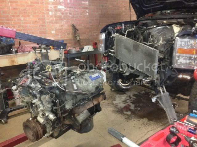

Took me 4hrs and a lot of wire for jump starting the motor.. Also pulled off my single turbo... You'll still hit the wall with either the manifolds or the hpfp
