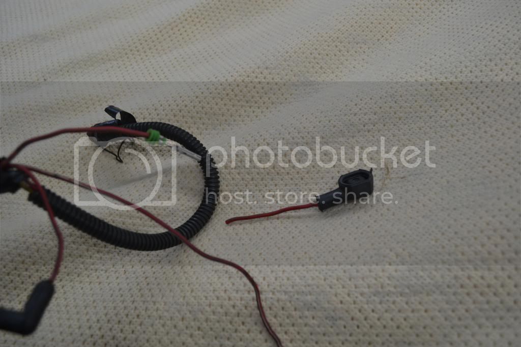

Not the best pic but I cut the end off the fuel heater wire and crimped on a Weatherpack terminal.
