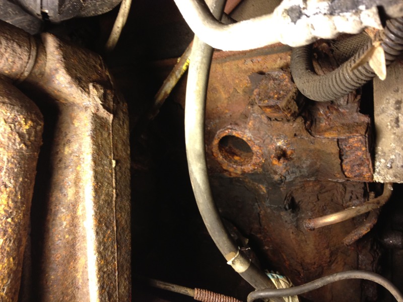

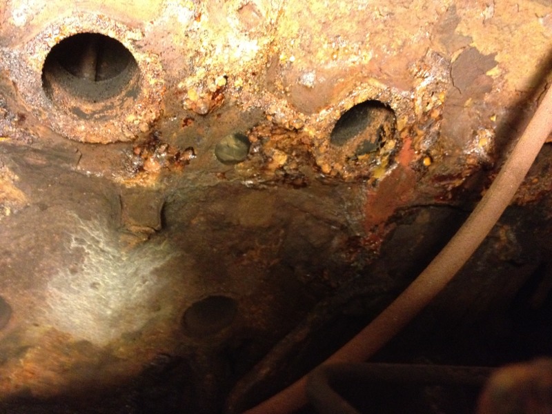

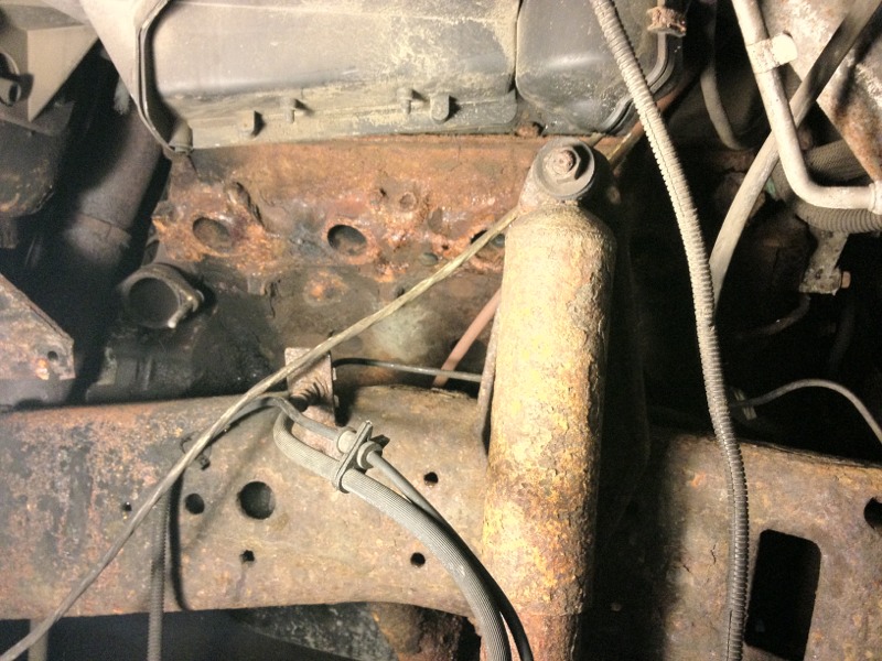

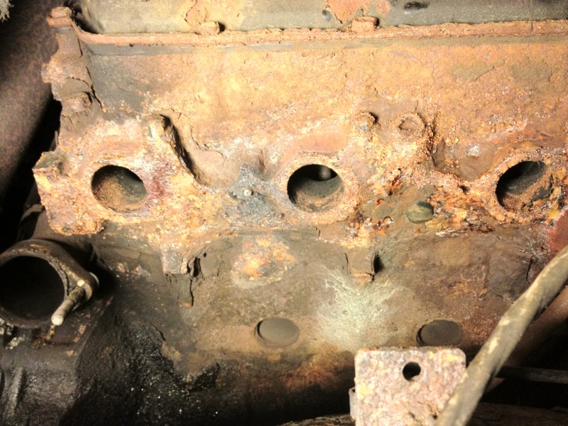

Here are some photos of how bad it is.
TyCorr
Jun 23, 2011
15,461
Head =250lbs,iirc. No joke moving one.of.those.
I would try to.get them out. If you are.going to have to buy new cylinder heads anyway, then give it a.shot. Take the wire.wheel to the rusty mess.and.then heat them ***kers up. When they are hot, hit em with penetrant.
I just looked at your photos....holy fugg. You might have to start.over, you're.right. Those.are.***kin gone.
